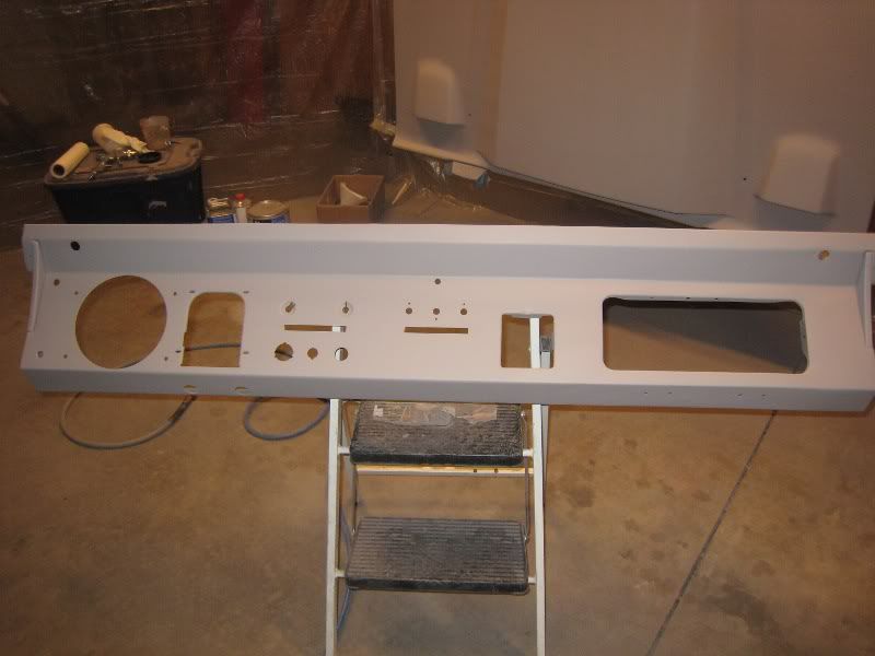

Postby dsmith01 » Fri Apr 08, 2011 6:51 am
While I was waiting for the paint guy to show up yesterday to give me an estimate I started working on the my dash a little. Before I knew it I have the glovebox cut out and moved 3" to clear the rollbar. After work today I'm going to fill the rest of the holes and prep for the dash for paint.

Postby Jesus_man » Fri Apr 08, 2011 7:24 am
I have never seen someone just move the glove box over 3".
A friend of mine in TX had a bronco that the whole dash was shortened 3" either side and that allowed for the roll bar to tuck neatly between it and the door. If I ever do a new cage, I will probably go this route.

Postby dsmith01 » Sun Apr 10, 2011 9:06 pm
69 Bronco 69 wrote:You do really nice work. Good to see progress made at a regular pace with so many members on here. I was going to give you some pointers about the body work ( I used to do that stuff years back, went to school for it etc etc) but it looks like you figured it out.
Thanks!
Since today was better weather than expected I was able to get out and finish up the dash. I also blocked the Bronco and shot a couple more coats of primer. Should be able to deliver for paint in 2 weeks.
