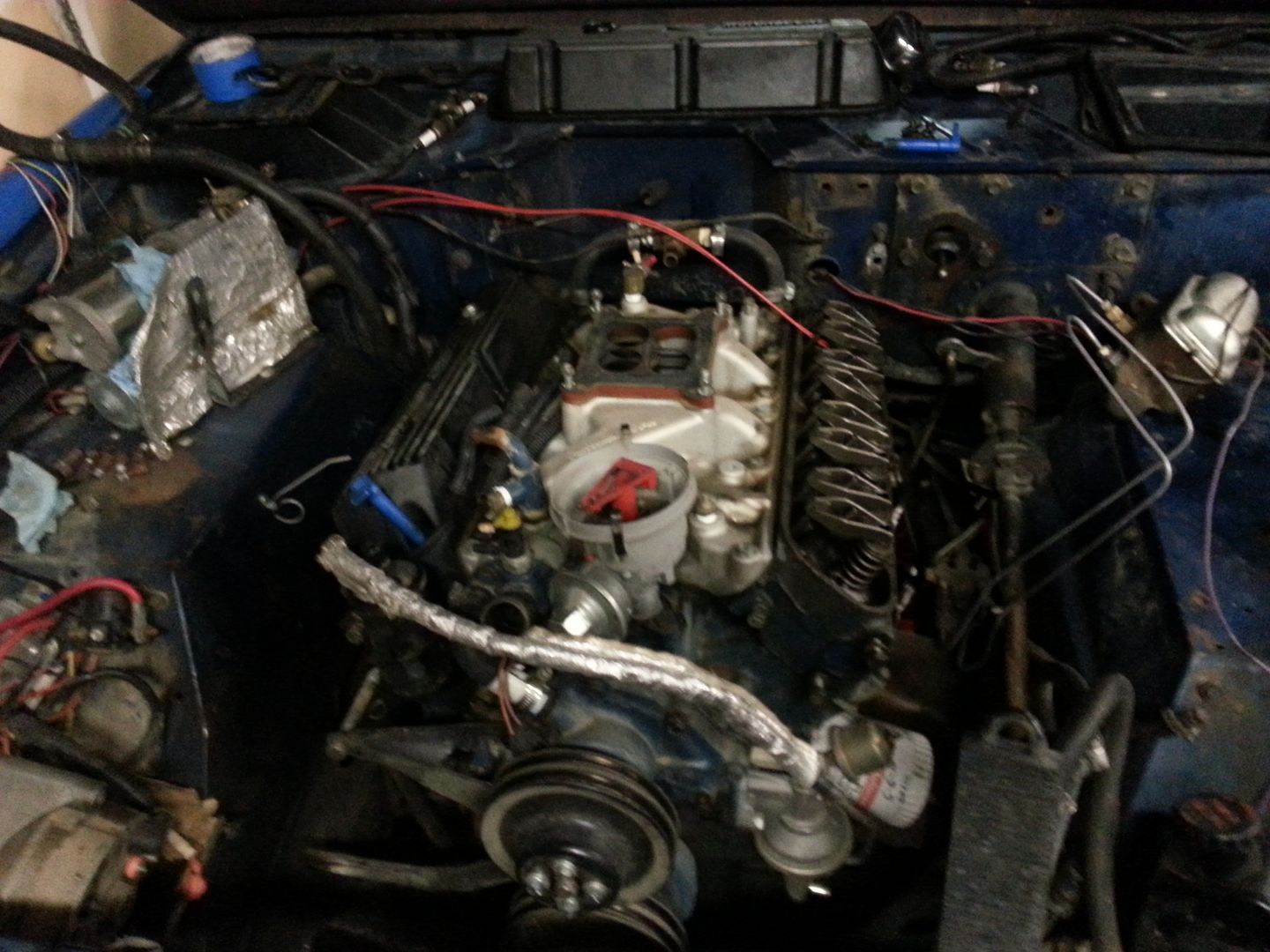

Digging that aluminum foil on the fuel line.
Re: ZOSO's toys
Postby ZOSO » Mon Nov 23, 2015 6:29 pm
It helped. It's a sleeve. Along with the carb spacer and rerouting the fuel lines.

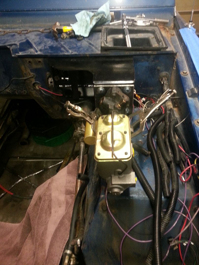

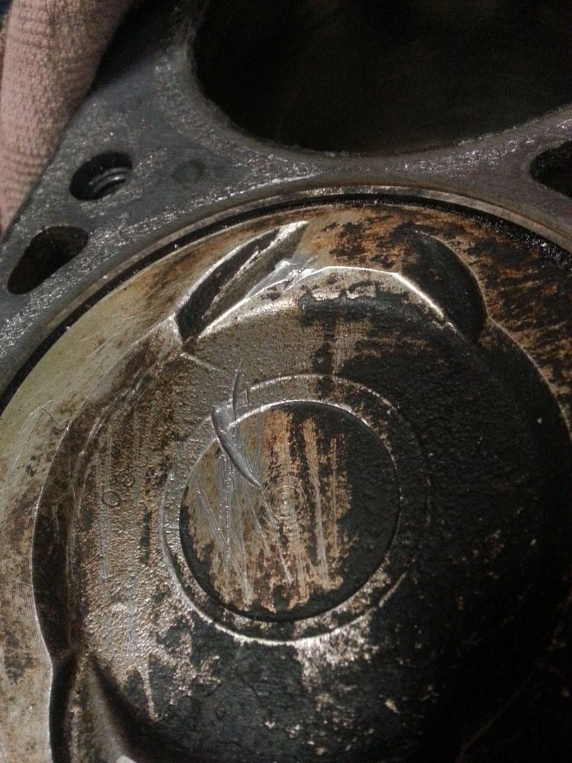

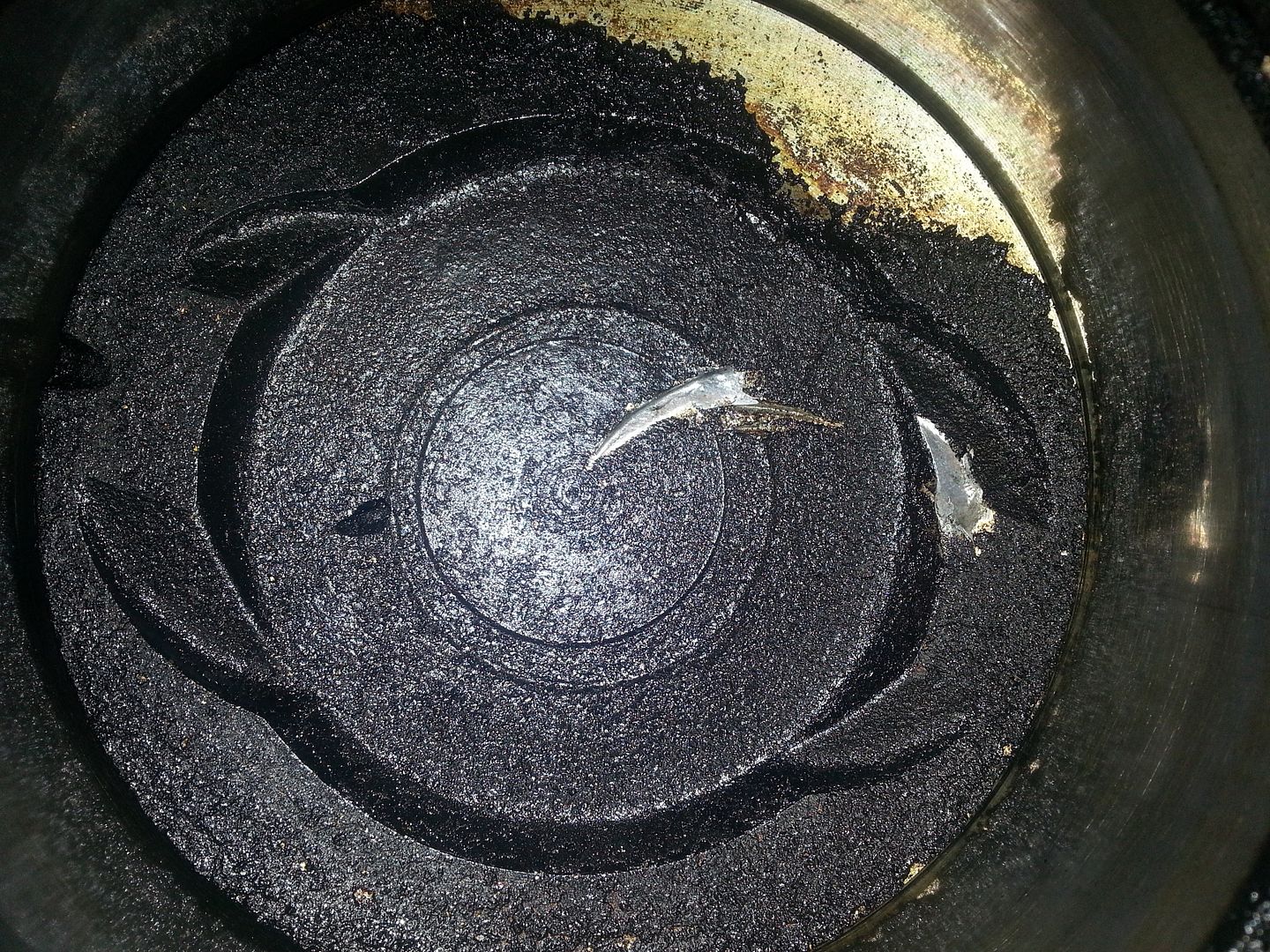

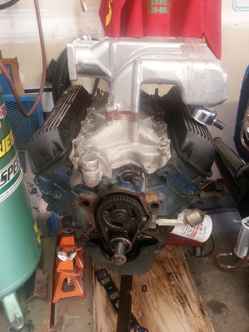

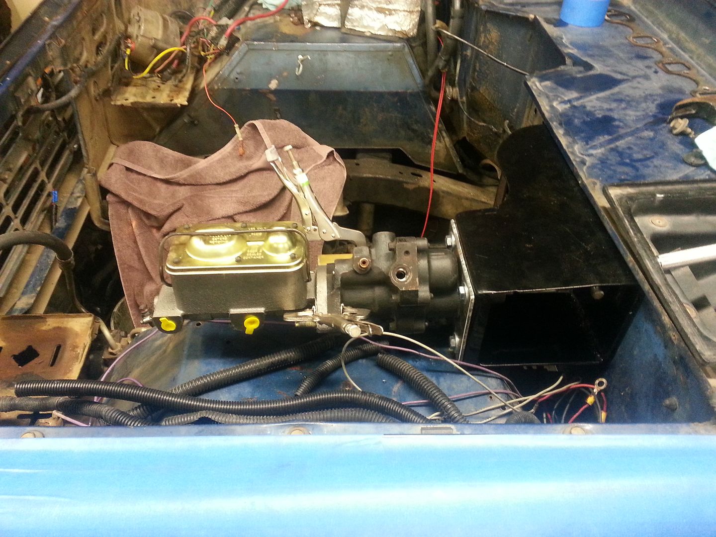

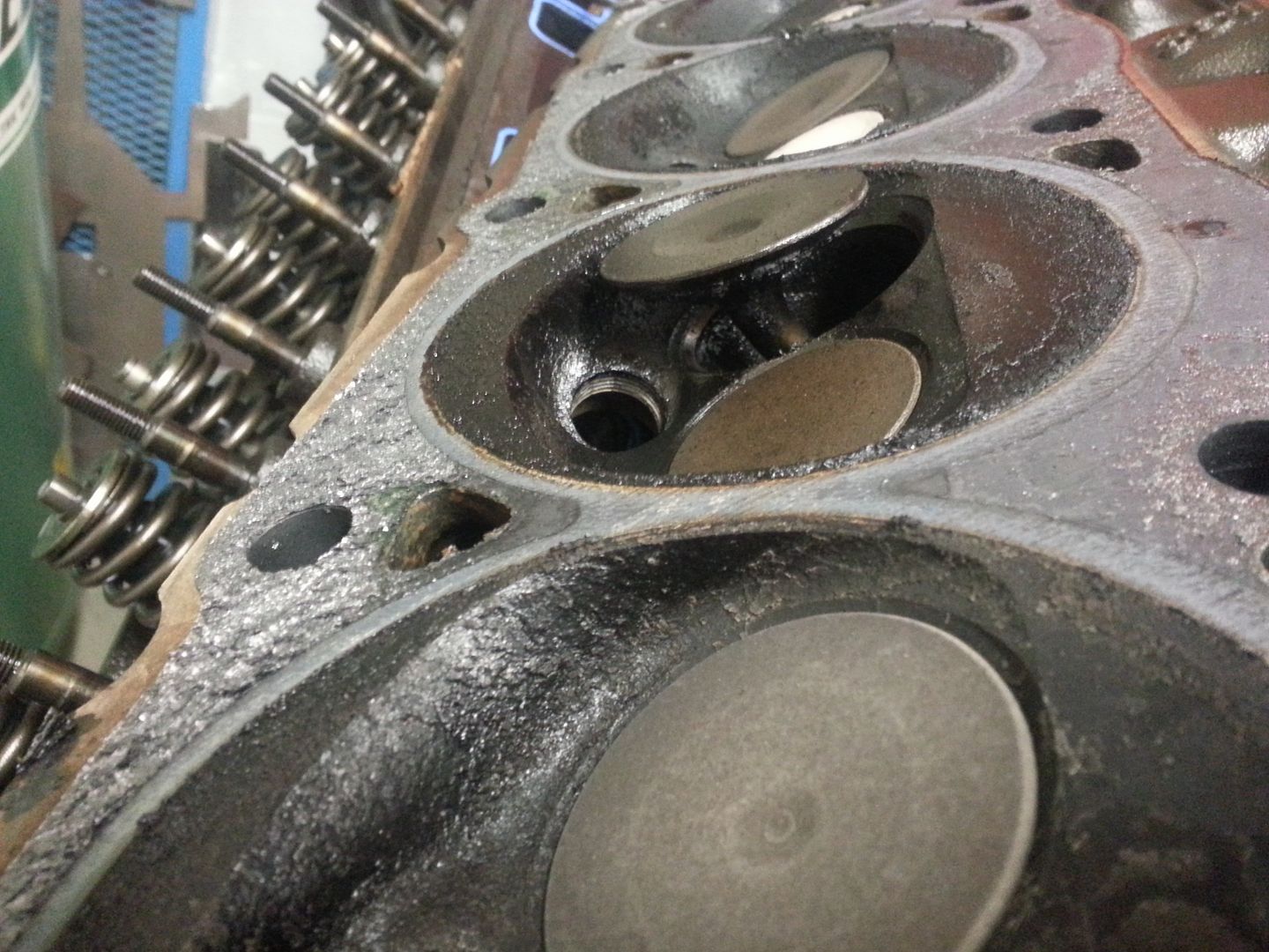

I have started the mockup of the hydroboost and bracket. I plan to make the brake lines and get everything ready then remove it all until the engine is back in. With this offset bracket it sure is long.

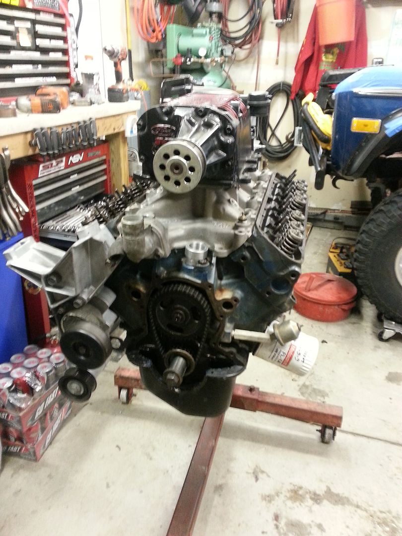

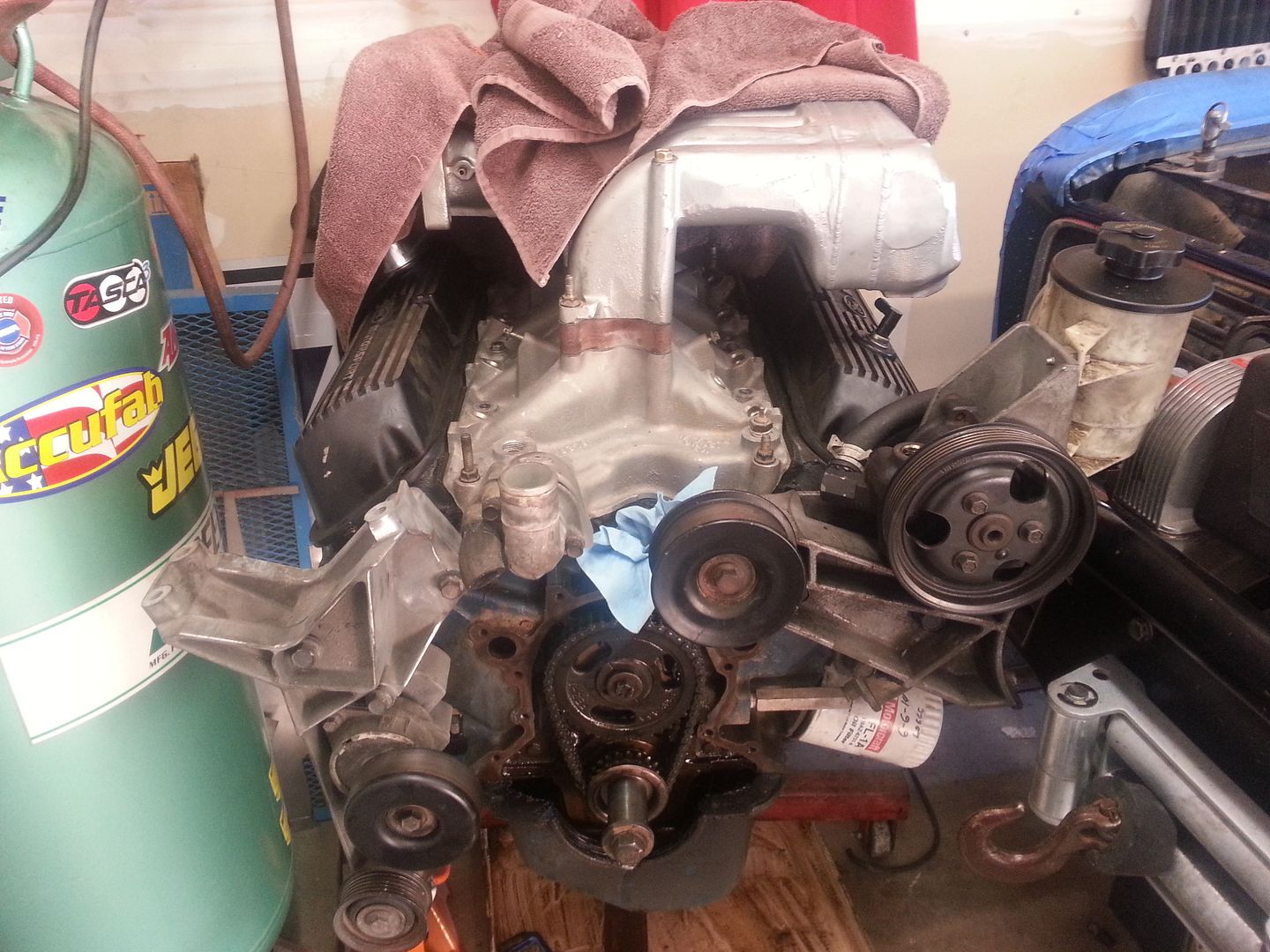

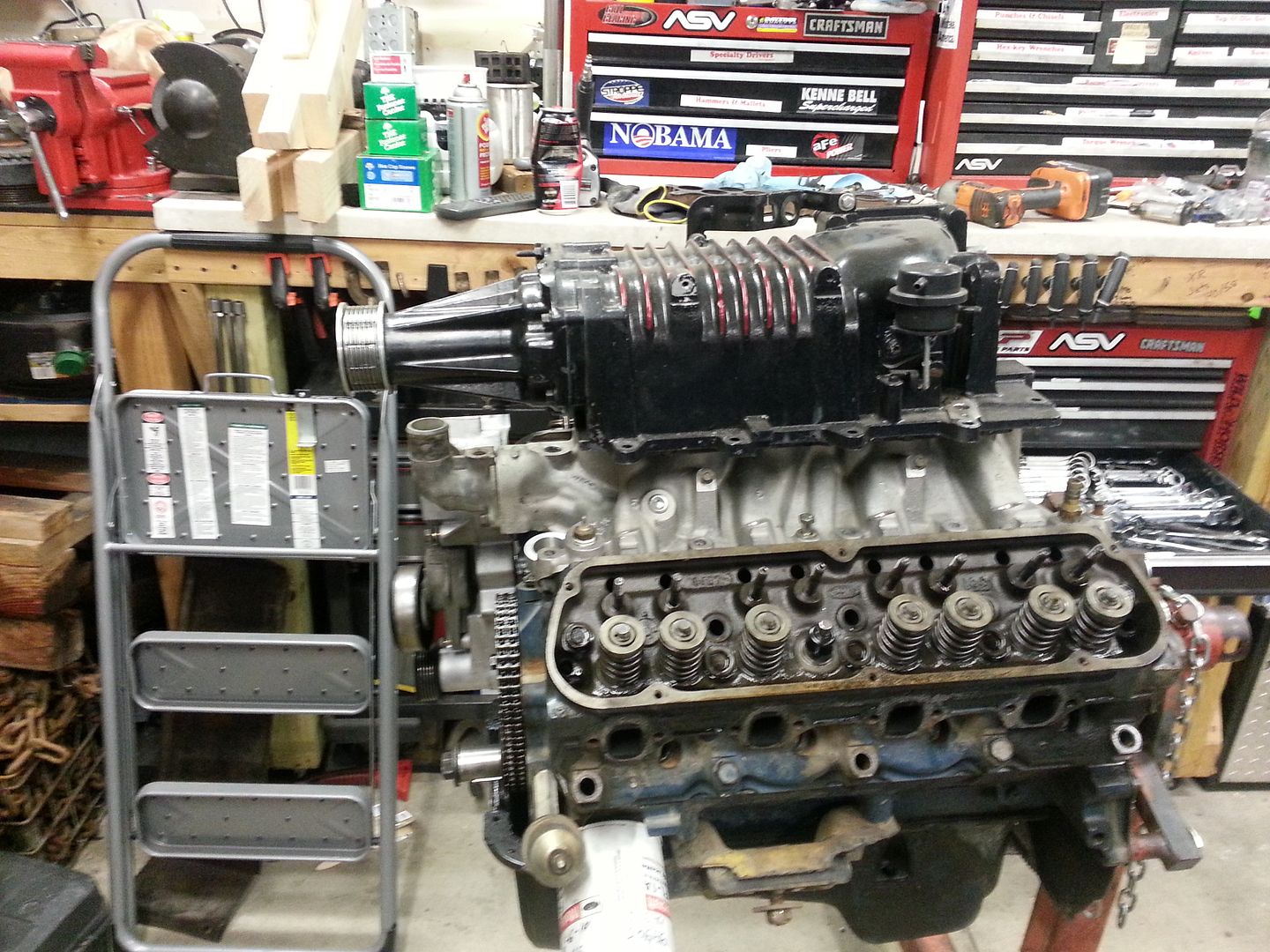

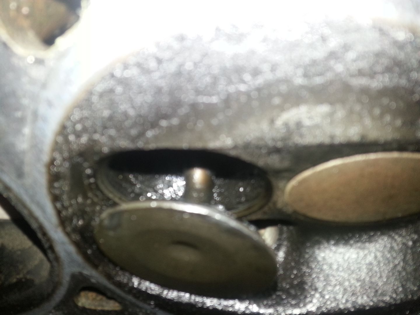

Also started the tear down of the engine. I think I got pretty lucky. Doesnt look like the piston is hurt. there is a mark on it from the valve but doesnt looked cracked. So i'll clean the carbon off and slap on some new heads.

I couldn't help but mock some things up. Will be sand blasting the brackets to give a nice finish. Will Paint the upper also.

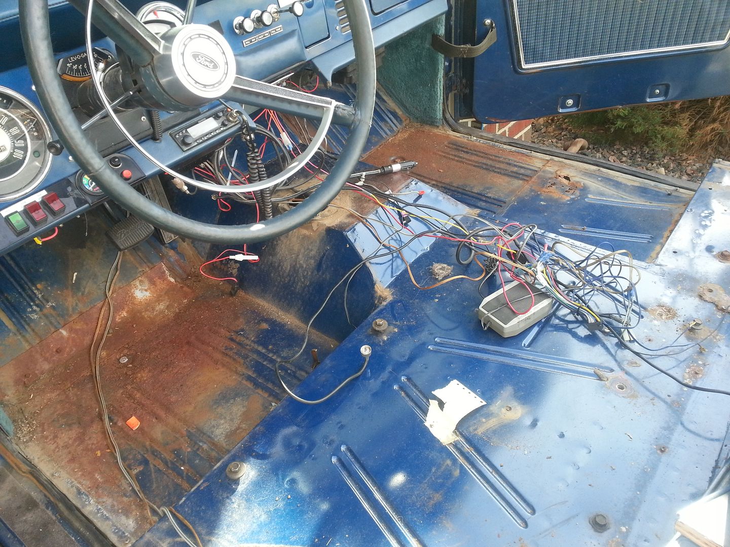

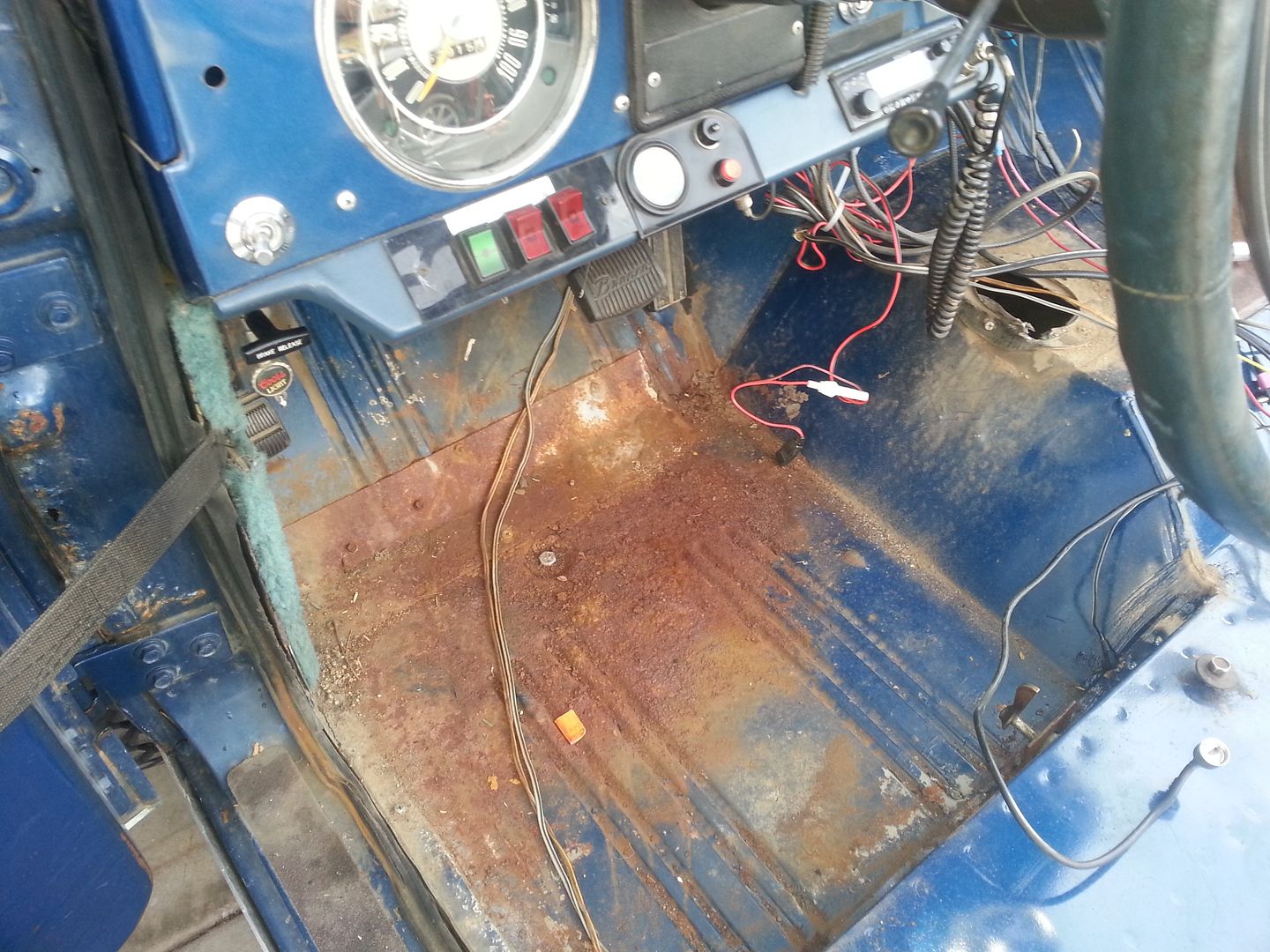

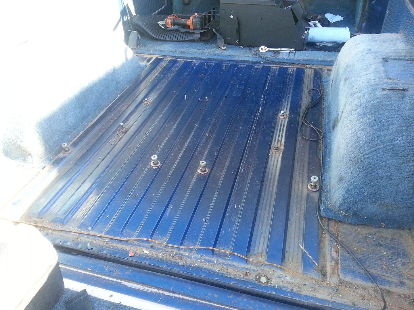

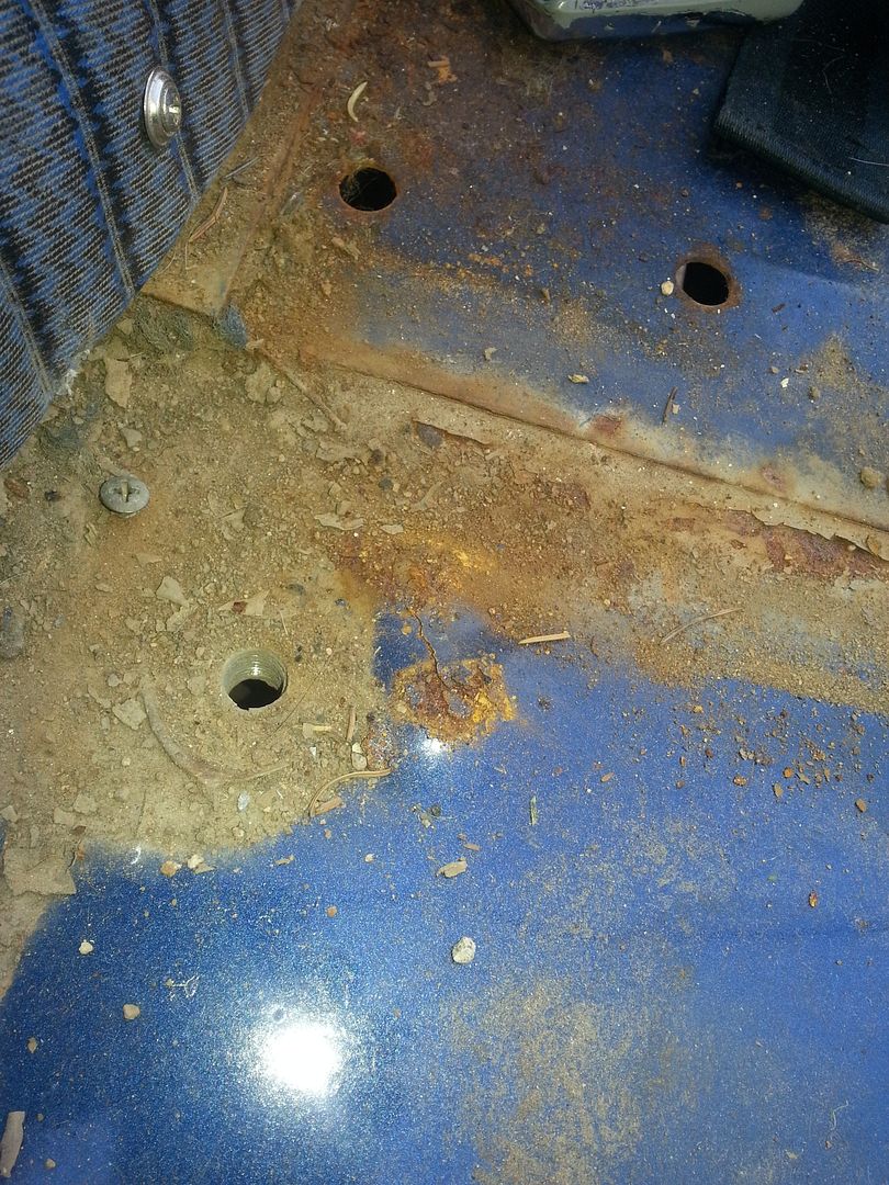

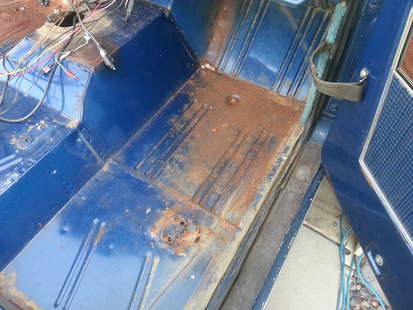

Postby ZOSO » Fri Dec 11, 2015 6:17 pm

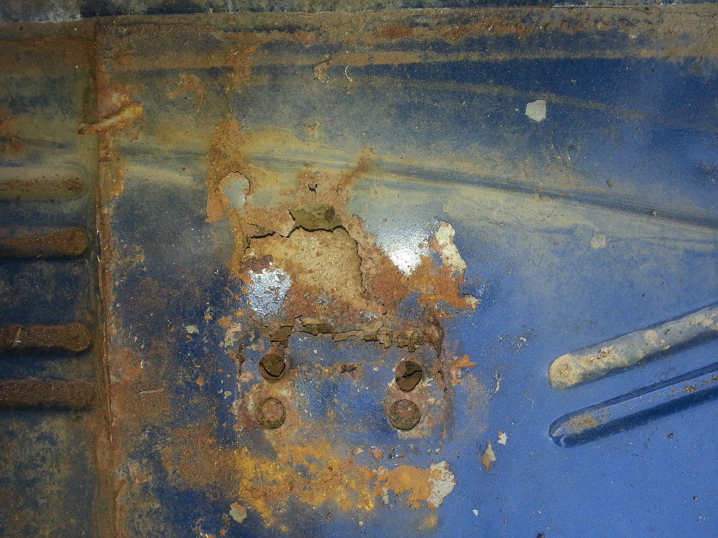

Was very surprised today. I pulled the interior and carpet. I found a lot less rust than I expected. Looks like a small patch is required at the seat bolt holes on the passenger side. and maybe a full drivers pan since it's been patched once.

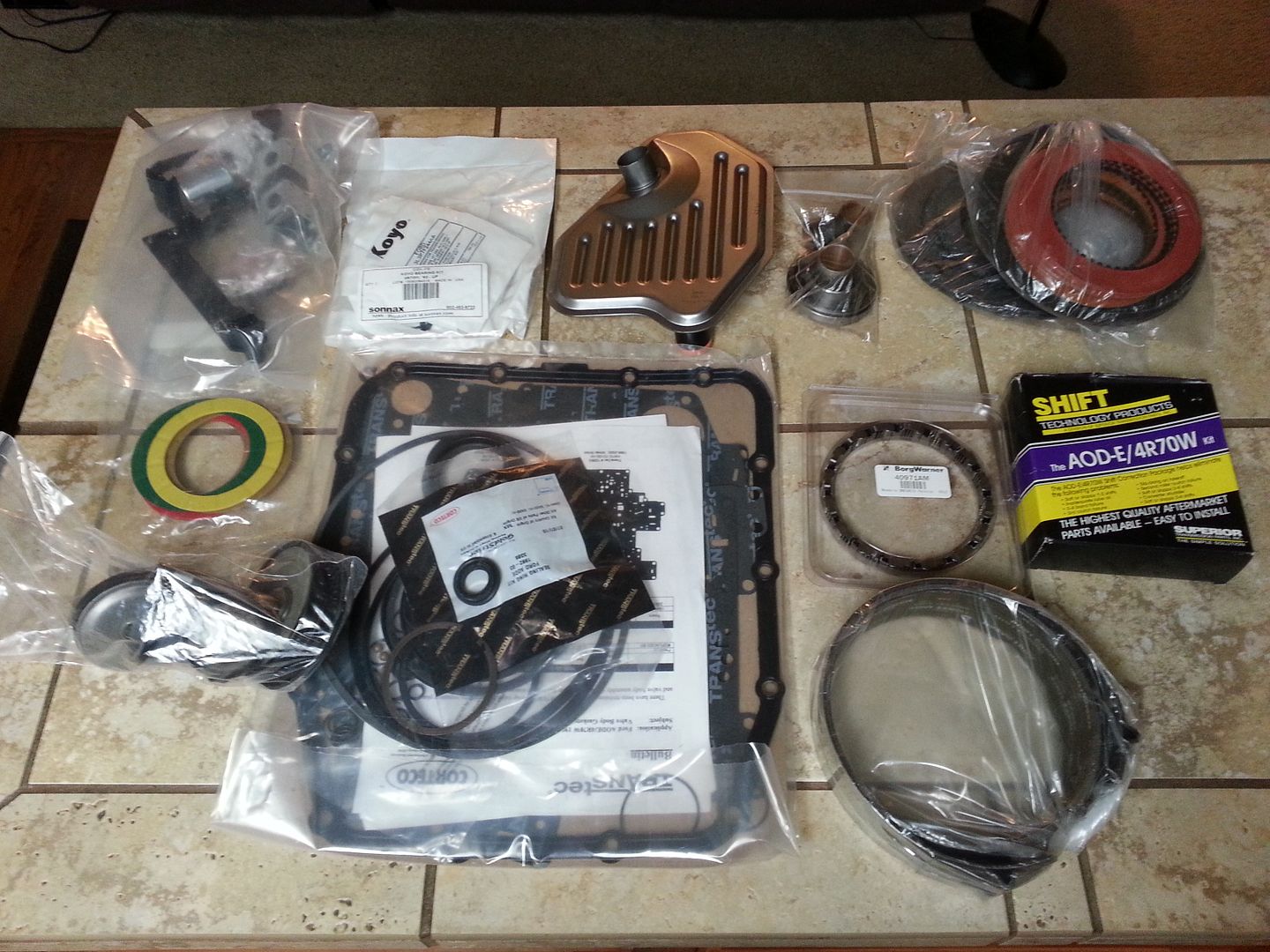

trans kit showed up. Has a new roller clutch in the kit. Will possibly sell the shift correction kit and get a sure cure kit.

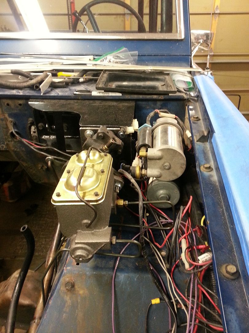

Re: ZOSO's toys
Postby ZOSO » Wed Jan 06, 2016 6:11 pm

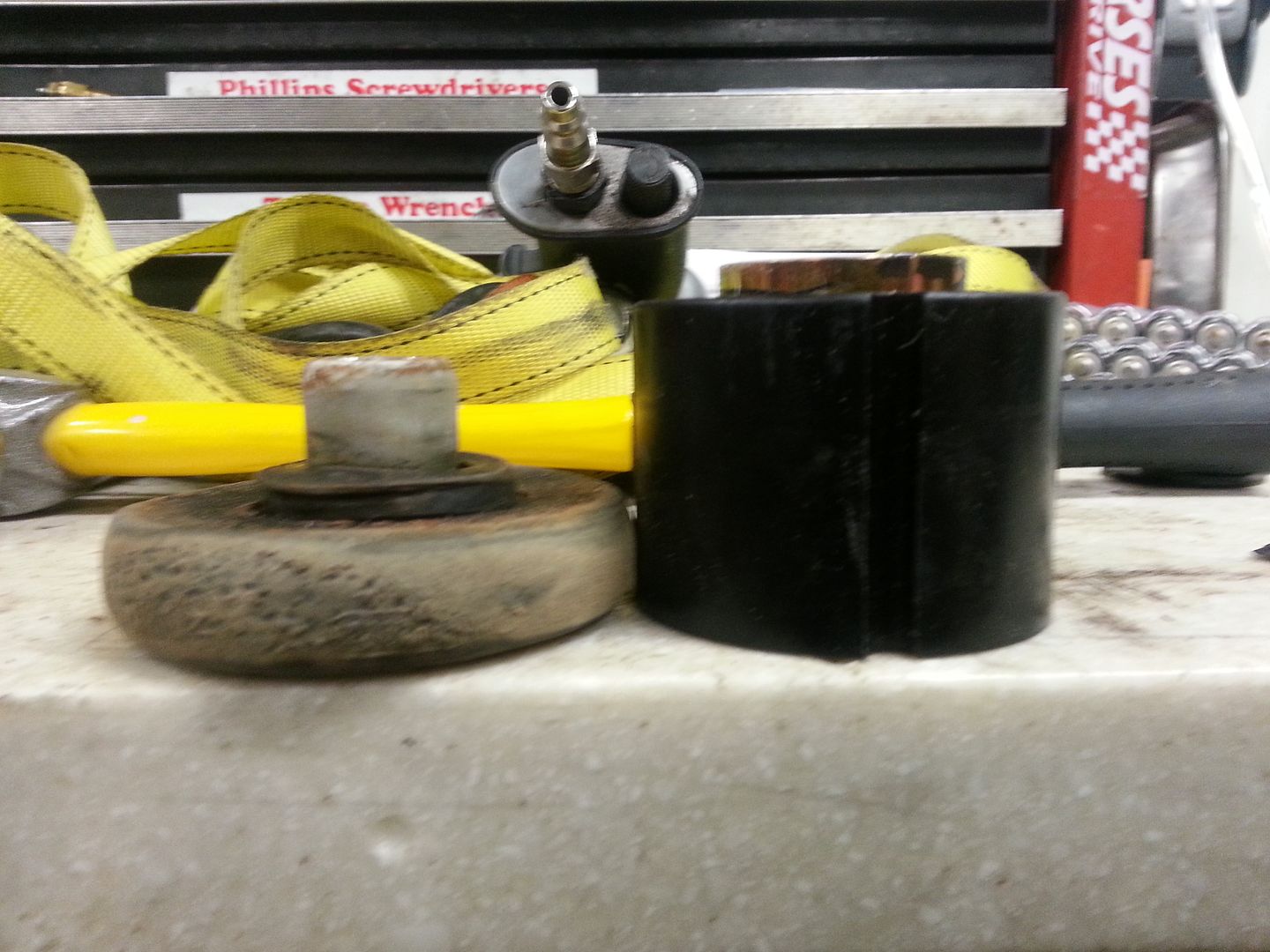

The original body bushings had seen better days.
Going to be a tight fit with everything crammed under hood again.
Hey Garry you ready to build some adaptors? Looks like it would fit awesome.

Postby landshark » Wed Jan 06, 2016 10:45 pm
is that a compressor next to the hydroboost? can you move it? maybe under the bronco?
Re: ZOSO's toys
Postby ZOSO » Thu Jan 07, 2016 6:01 am
landshark wrote:is that a compressor next to the hydroboost? can you move it? maybe under the bronco?
Yup. OG ARB compressor. It was mounted to the passenger side. I needed to move it to have room for the intake/maf/air filter.

Still gathering parts. I ordered the new reverse drum and mechanical diode and sure cure kit for the 4r70w. Also ordered the 98 n up case connector. Once those arrive I can finally make some progress and get this trans rebuilt.
