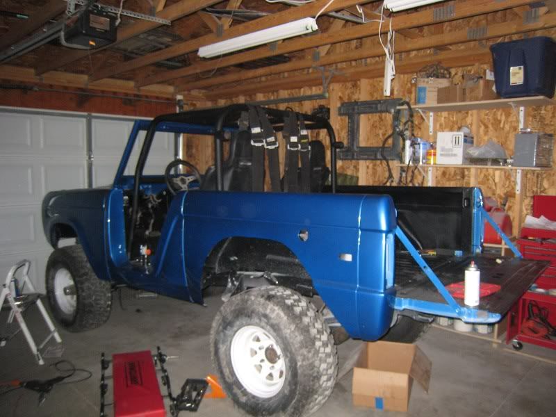

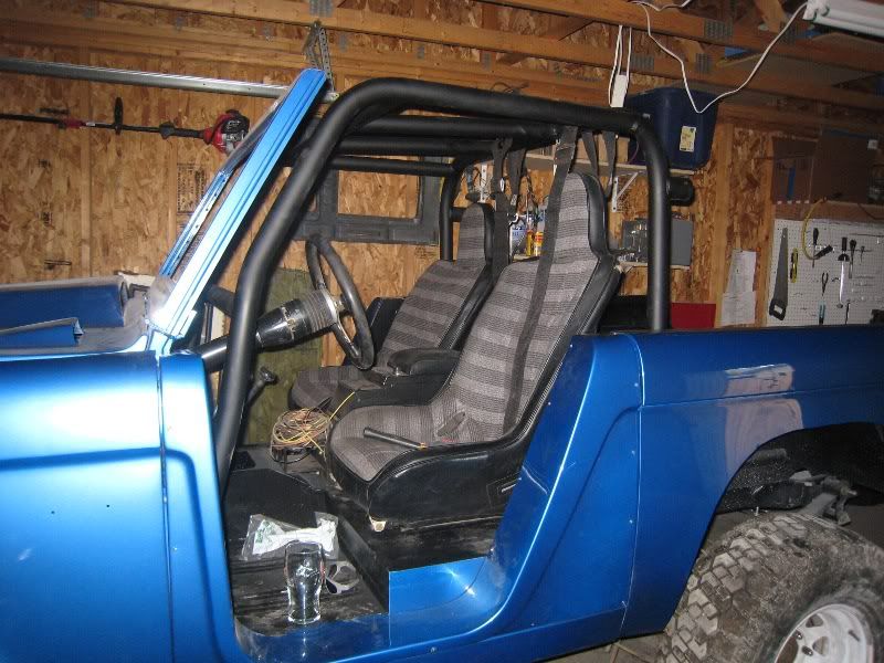

Got it back from the painter on Monday and I was so excited I decided to take yesterday off from work so I could put it back together. I was so busy yesterday with the Bronco I didn't have anytime for web wheeling or pic posting.
I got brakes and steering installed and then I moved onto the interior. Got the seats, center console and roll cage installed.
Had a little time left in the day so I installed the fan shroud. FYI, the fan shroud from a mid 90s V6 Ford Ranger fits like a glove on the early Bronco radiator with an Explorer front dress. I'll shoot a couple pics tonight and post them later.
Everything is a little dusty but should clean up nice.

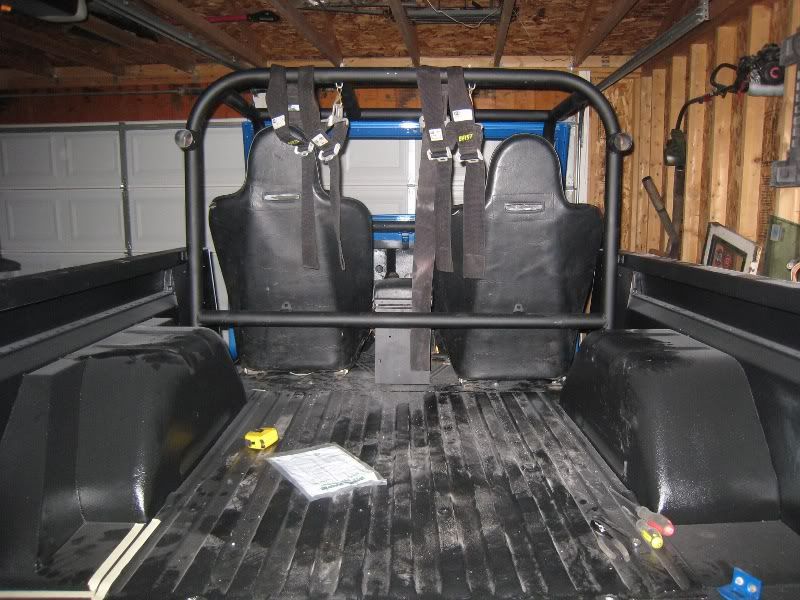

SEM Pro-tex bed liner
Hood is sitting on top of the hood pins

Looking good! Are you planning to install a harness bar?
Re: 72 restore/mild build
Postby ZOSO » Wed Jun 01, 2011 8:53 am
Looks great. You need to teach chad how to put it back together.
Postby dsmith01 » Wed Jun 01, 2011 9:31 am
Justin wrote:Looking good! Are you planning to install a harness bar?
There is a harness bar with 2 tabs for the shoulder straps. Lap belts will use the original seatbelt holes in the floor.

Postby Justin » Wed Jun 01, 2011 1:51 pm
You may want to consider installing another bar farther up on the cage. See this thread: viewtopic.php?f=4&t=1189&p=15344&hilit=harness#p15344
Postby dsmith01 » Wed Jun 01, 2011 3:17 pm
Justin wrote:You may want to consider installing another bar farther up on the cage. See this thread: http://www.coloradoclassicbroncos.com/v ... ess#p15344
Well ain't that a PITA. Looks like I'll be cutting/welding right next to my new paint job now bangtard
