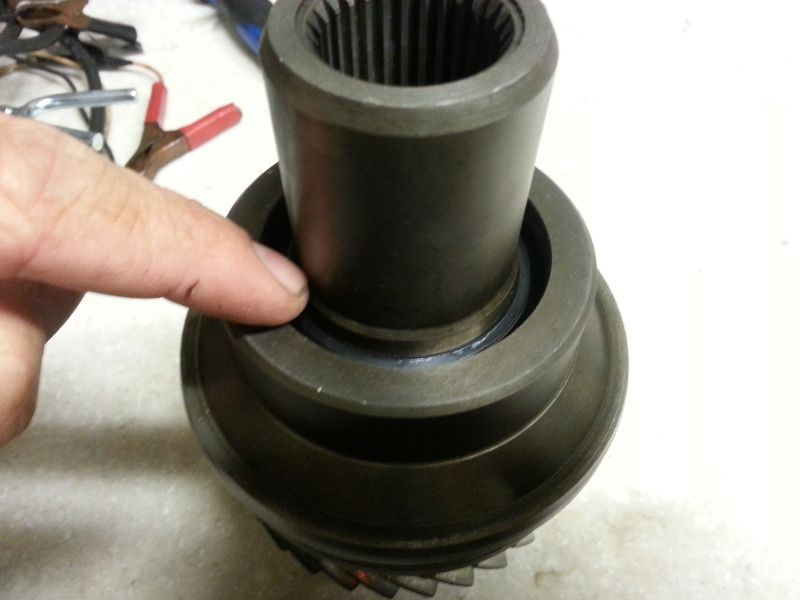

I have been leaking fluid from my dana 20 since I installed my c4 and the rebuilt viperwolf dana 20. I noticed there is fluid coming out the vent. Did I miss a seal and or a step in my install. I think I have transmission fluid in the tc cuz the royal purple is more red now. I've al been a np435 guy so this is my 1st auto install

Just to confirm, the vent for the t case? I'm no C4 expert but if you have trans fluid filling up the void b/t the trans and the t case and then building up in the t case I'd say the seal is missing or failed. Is your ATF low?

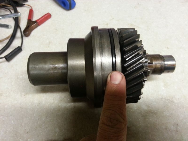

There is a o ring on the bearing retainer big aluminum pc that was chewed up a little. Thought it would be fine.

77 there are 2 places they can leak together. Both require pulling the t case to change. And if you do one better do the other also.
oring
seal
