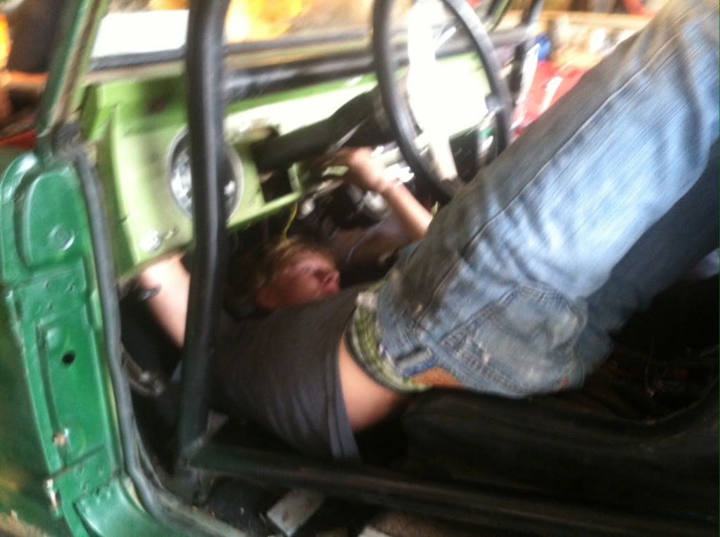

Postby hockeydad4-22 » Tue Jan 06, 2015 10:24 am
it helps if you can sit like this for 30-45 minutes or so....
