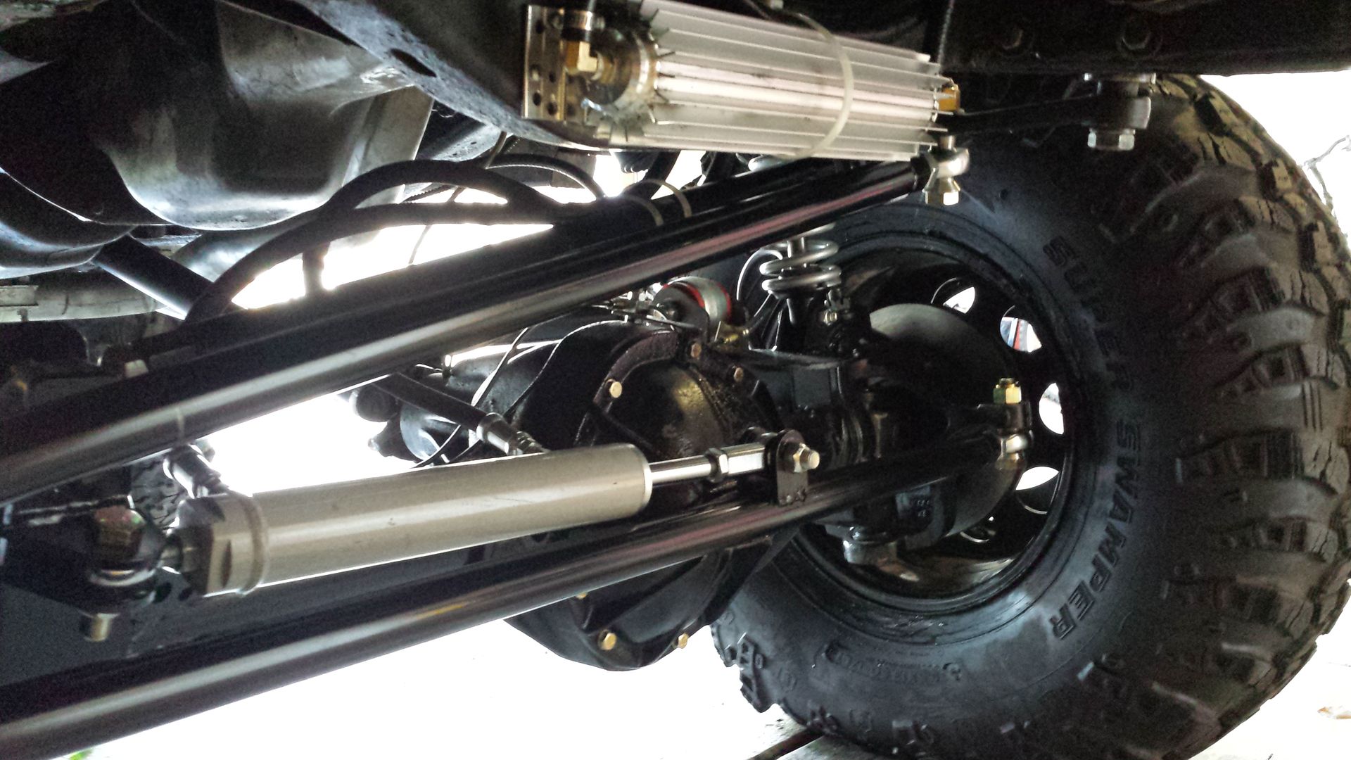

Here's how I did mine:
I got a shorter nut for the backside and the bolt still ticks the diff cover, but it's a non-issue for me! Aside from a leaking fitting now and then, I have had zero issues with my setup!

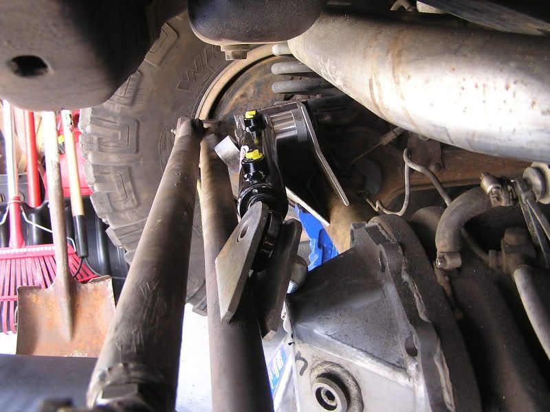

Reviving a dead thread to ask another question on this. My track bar setup is essentially identical to Trei's photo above, except that I'm running tie rod over so I can't put the ram in the same spot he did. My track bar is also mounted one hole lower in the bracket (about an inch lower than his). Could I get away with running a longer 9/16" bolt and mounting the ram on the face of the track bar bracket? This would have one bolt supporting both the track bar and the hydro assist, but I'd mount both in double shear. Think Big Mac, with metal plate for the 3 buns and the components for meat.
My other option is to mount the ram directly below the track bar inside the track bar bracket. It'll work OK, but there is more angle between the tie rod and ram, so I'm a little worried about added wear on the tie rod ends and creating a rotational force on the tie rod. I can take pics tonight if this is clear as mud.

Justin wrote:Could I get away with running a longer 9/16" bolt and mounting the ram on the face of the track bar bracket? This would have one bolt supporting both the track bar and the hydro assist, but I'd mount both in double shear. Think Big Mac, with metal plate for the 3 buns and the components for meat.
I'm pretty sure that is what JD did. If you look at his pic above, the track bar isn't installed, but there is a spacer, behind the ram, where his track bar mounts. I know there is another pic I've seen, I'll look for it.

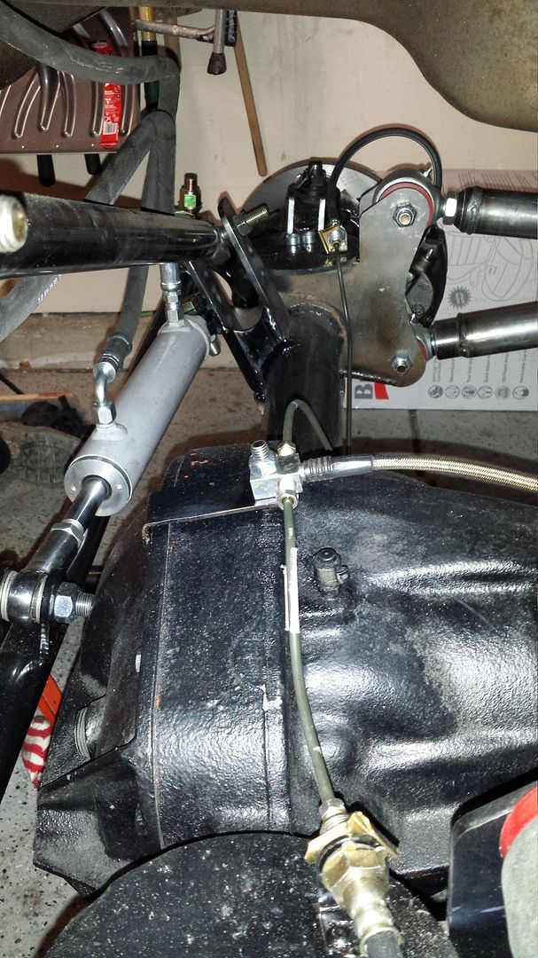

Figures. I ought to start a "Justin's random questions" thread so that all this stuff stays in the same place. I spent a little more time in the garage and have run into clearance issues with almost any mounting on the face of the track bar. Below are pics of the current plan. I don't think the angle is too steep, but it's steeper than I'd like it to be. Driver's side is at full stuff and the steering is cranked fully to the passenger's side, which is the worst case scenario for clearance. Everything is pretty tight, but clears well enough.

Justin - I don't see a thing wrong with what you have, so long as you can route hoses so they don't contact anything. And if they are rubbing on stuff, a piece of 1" heater hose works great as a chaff protector.

Justin I have 1/4 to 1/8 inches in some areas. That geometry looks pretty good. Remember when you have a tire on there the fender will most likely limit you anyway. I like the track bar to be as flat as possible. I would say run it don't over think it
