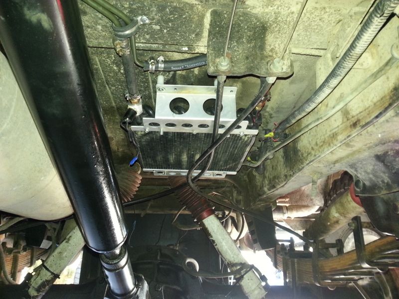

Ok so my next question, Is there too long of a line length? Here's my plan. From trans(5/16) to radiator(1/8). Radiator(1/8) to remote trans cooler(5/16 line 3/8 cooler ports). From there back to the trans. now I have 2 options. Mount the cooler under passenger floor(not preferred). That would keep lines short. Would have to build a cage around the cooler as it will hang below the rocker(cut off). Or option 2 is mount trans cooler behind trans/tcase above rear axle(current) but adds a bit to the line length. Would this be a problem? New trans cooler will be the same as the current derale 13900 16 pass with a fan.

My question above still stands. Is that too much line length? Since the rear cooler port feeds fluid to the back half of the trans I dont want to starve it with this long of a line length.

Postby ZOSO » Sat Feb 21, 2015 4:42 pm
If I run the lines the way I want they will be 6-8' longer than stock.
Re: radiator/stat for EFI
Postby Viperwolf1 » Sat Feb 21, 2015 5:37 pm
If you make them that long you should probably step up the diameter to 3/8". Don't worry about bottlenecks at the adapters because you would have them even with shorter lines.
