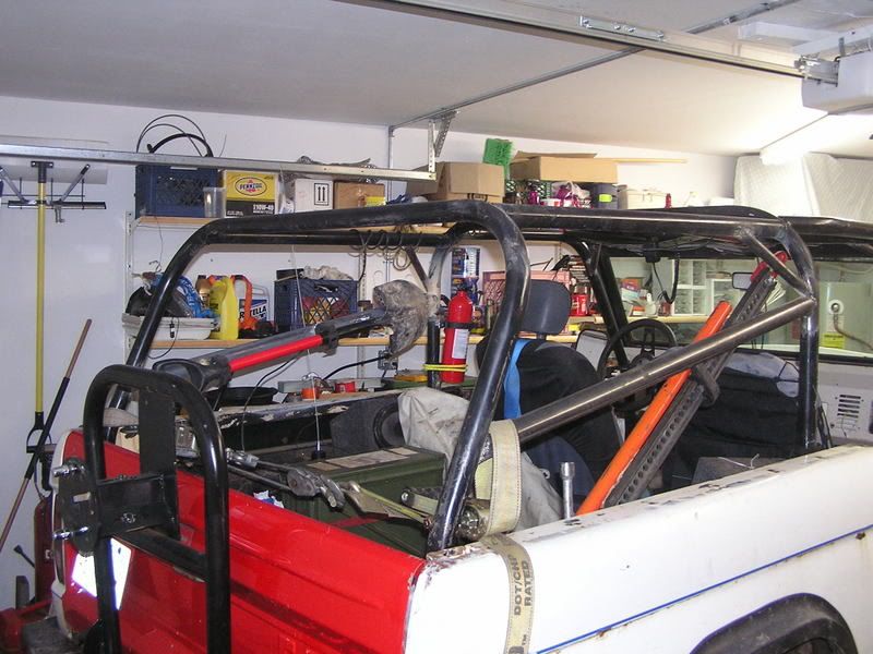

Postby sykanr0ng » Mon Apr 27, 2015 11:45 pm
This one is not mine, but I like it enough that I will probably do something like it:

Here's where mine is at. Difficult to reach it from the seat and pretty redneck, but it's worked.
There are certainly better extinguishers out there, but I don't recall what the most economical is.
