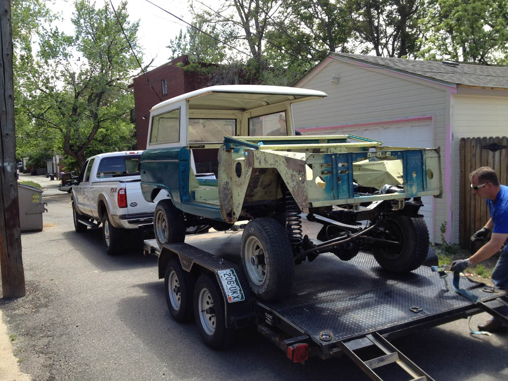

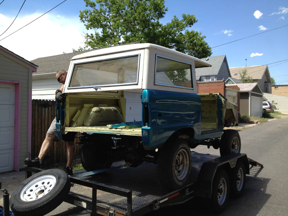

Dropped the top off at the resto shop and the rolling chassis with all the pieces off at the blasters...
Next time i see it hopefully it will be bare metal!
I will be taking allot of pics along the way....

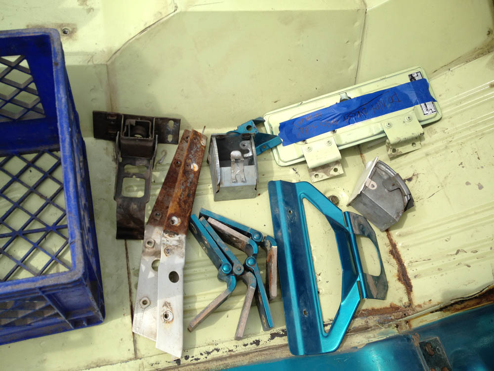

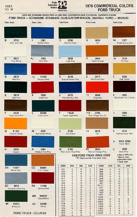

As they are going to blast the whole truck and iam going to repaint inside and out Iam trying to find the original color #'s to try and match (Color Code U). The only part of the truck iam not painting is the inside of the glove box door... something has to stay original ;)
I think the inside of the glovebox would be the most representative of the original color since its probably not fadded and hasn't really been scratched too much...
I think it will look nice...
Crappy copy but here are the paint chips from my year...

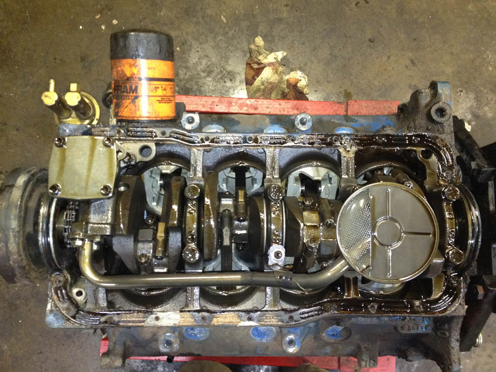

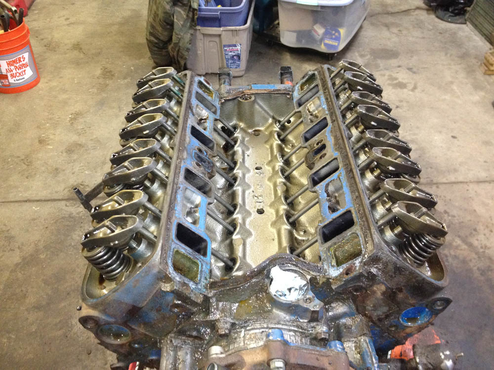

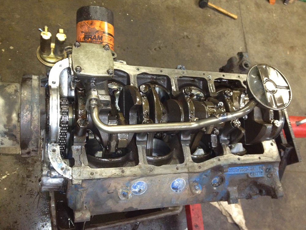

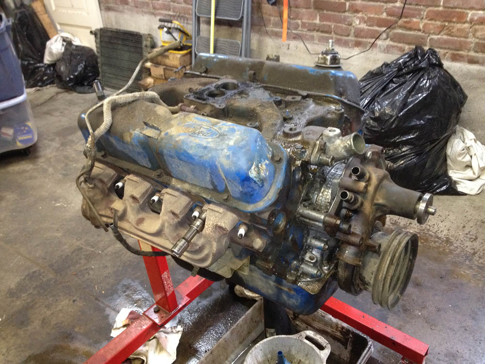

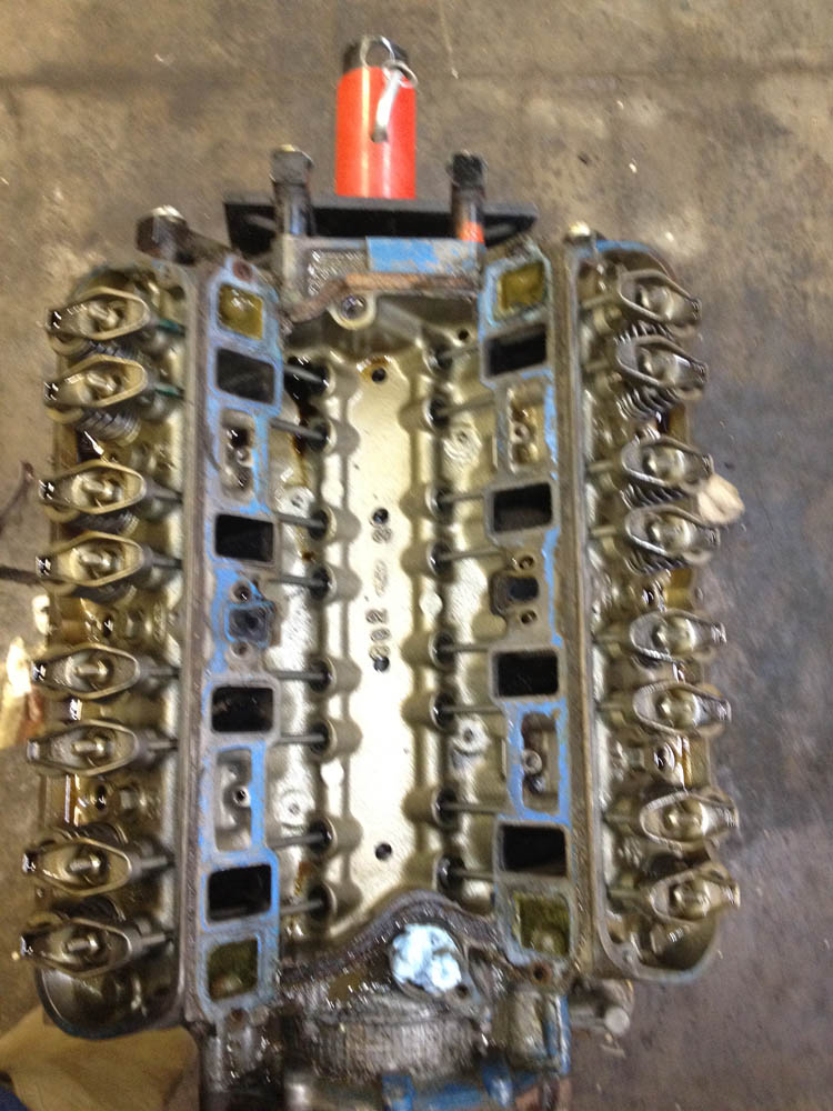

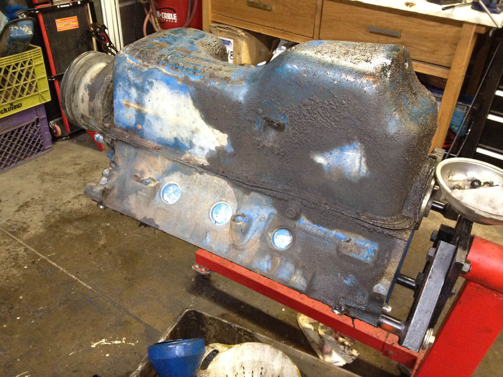

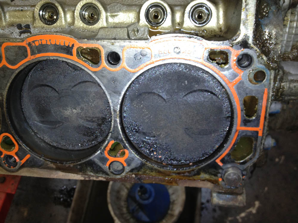

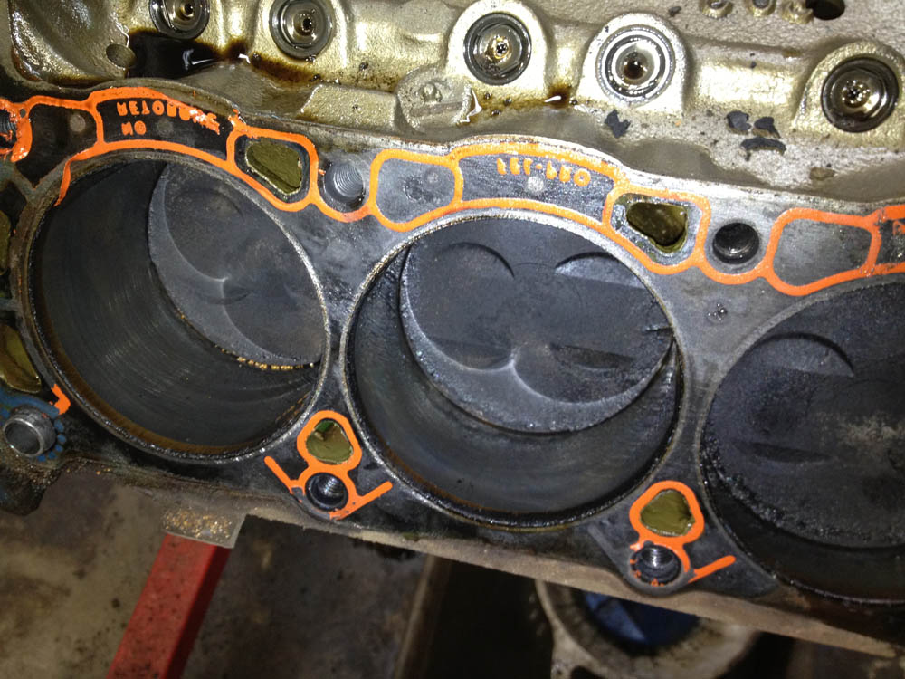

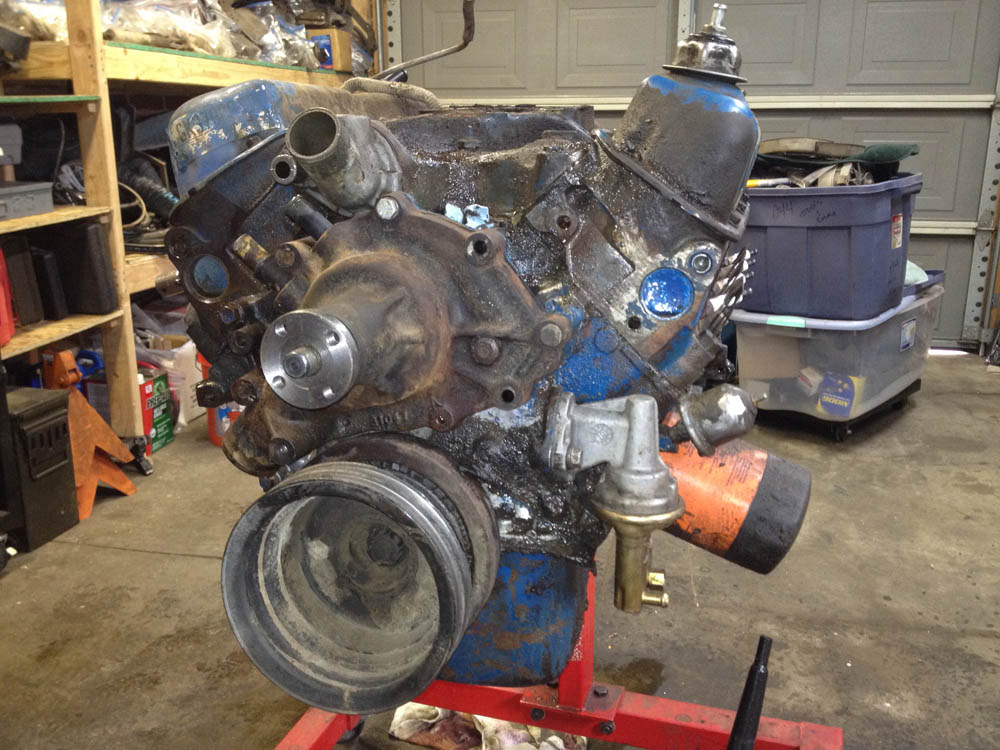

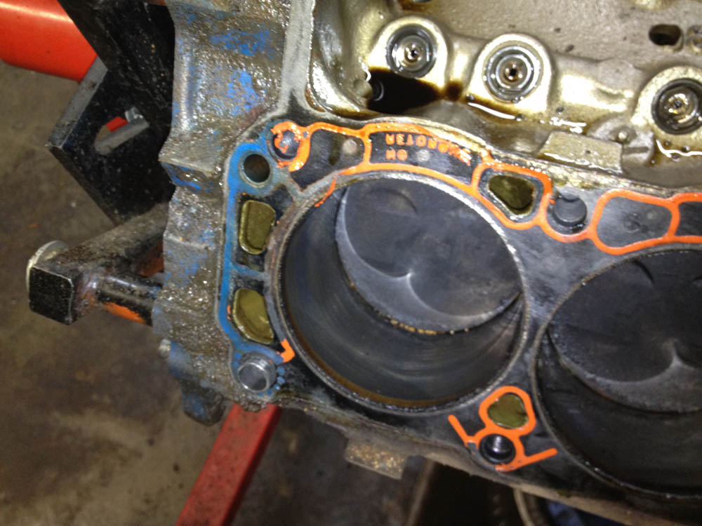

now that i have some room in the garage i was able to reorganize things a bit better and start tearing down the engine...

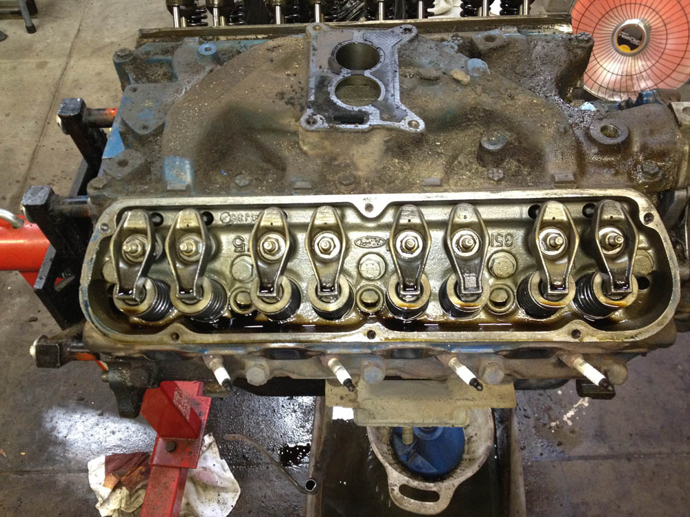

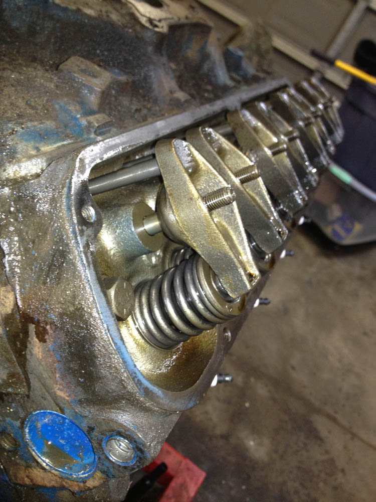

Took the valve covers off.. and
351 heads...

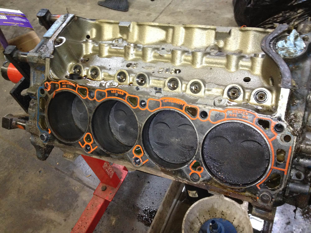

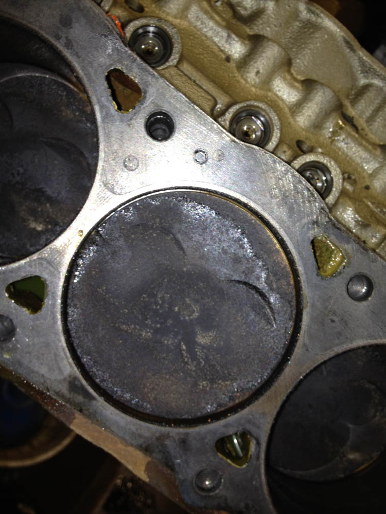

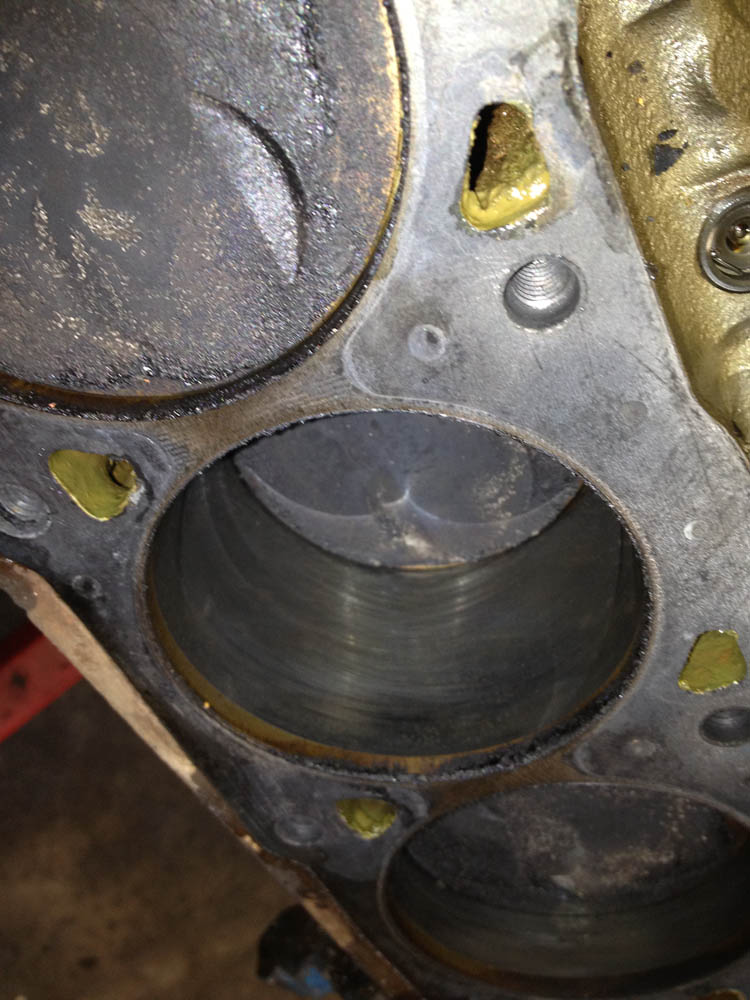

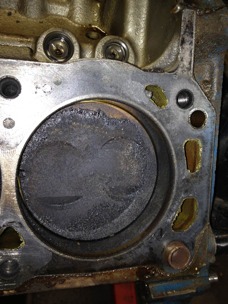

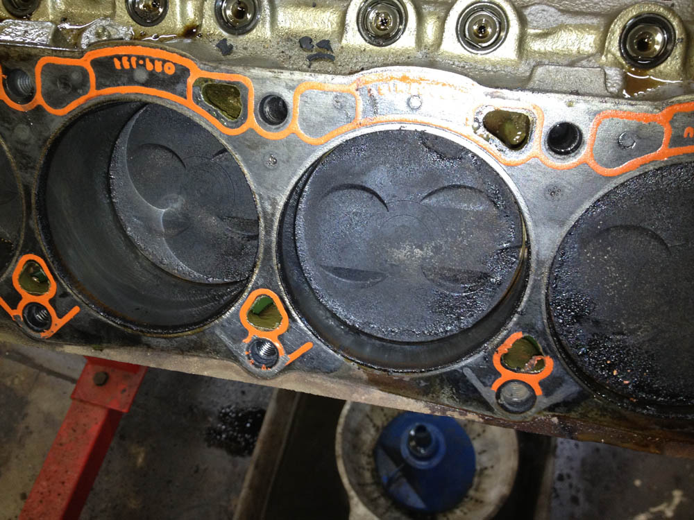

All eight cylinders... i guess they look ok? a little build up on the pistons is this normal? This is my first engine tear down..

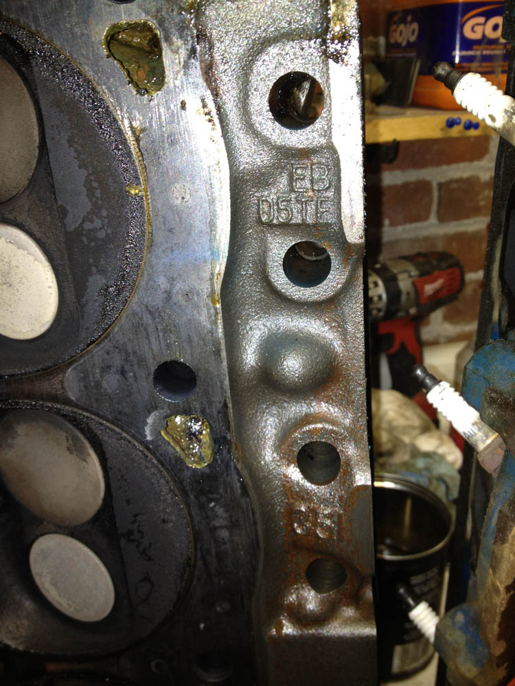

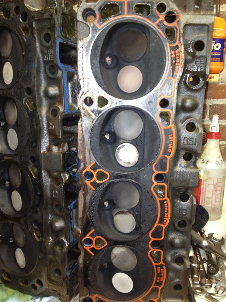

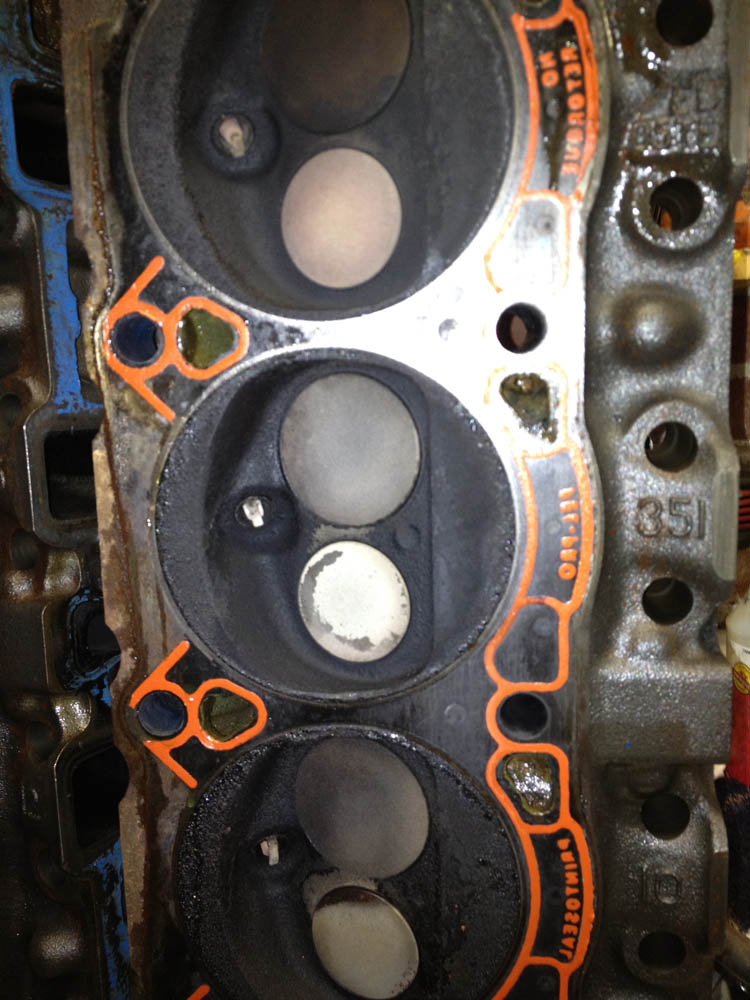

The heads.. D5TE - EB which i guess are pretty good heads from what my limited research has told me...

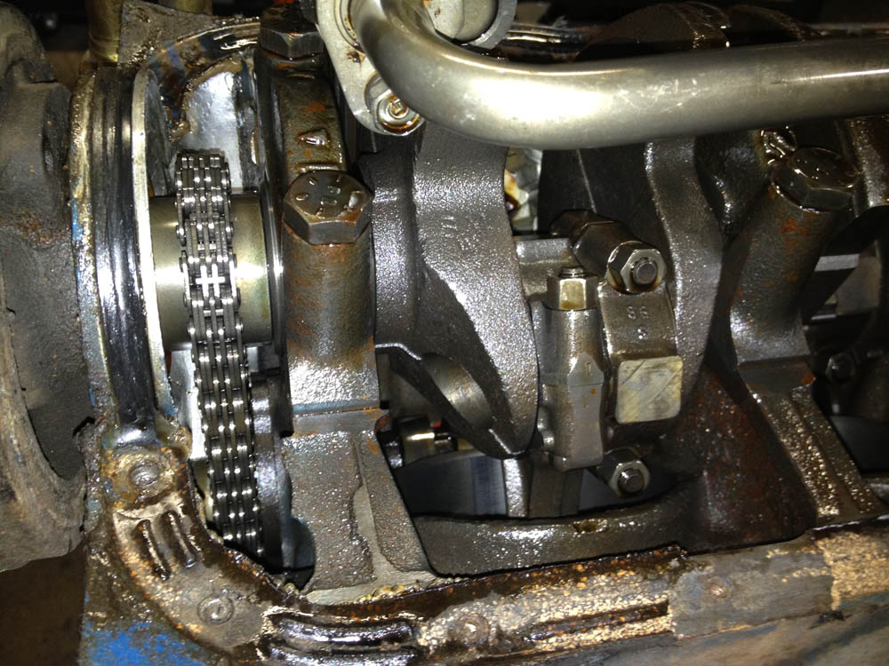

Continuing with the engine...

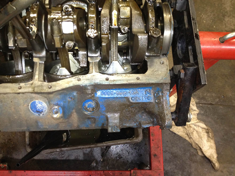

and the engine block number which I believe is D90E-6015-E3A which would make it 1979 engine.. i had misread the numbers and thought it was a 76 initially...
D9OE-6015-E3A
D9 = 1979
O = Fairlane, Torino or Tbird
So now my delima, the heads.... what to do.. what to do...

Postby Gunnibronco » Sun May 13, 2012 12:47 pm
Buy a block that matches the heads!

Postby ZOSO » Sun May 13, 2012 1:28 pm
Gunnibronco wrote:Buy a block that matches the heads!
I. Agree. Even tho if you bought a 351 you put it in the full size.

Ya so far opinion is get the e7's refreshed and run those. And your right I would rather put a 351 in the full size ;)
Re: Landsharks 76er Refresh and Build
Postby Viperwolf1 » Sun May 13, 2012 9:23 pm
17Nov78 is the casting date on the block. Heads look pretty normal. Some carbon on the pistons is normal. They look a little oilier than usual around the rings.

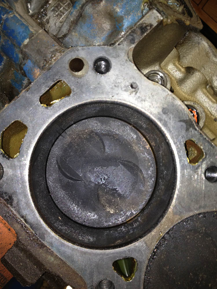

Postby landshark » Mon May 14, 2012 5:43 am
Viperwolf1 wrote:17Nov78 is the casting date on the block. Heads look pretty normal. Some carbon on the pistons is normal. They look a little oilier than usual around the rings.
I cleaned up the pistons, going to get the 351 heads that I pulled off cleaned up and put back on unless the E7's will fit, but will have to check the head bolts that came with this as I have been told a few times the head bolts are different.
Didn't see any scoring or definable ridges at the top of the piston bore which i guess is a good sign.

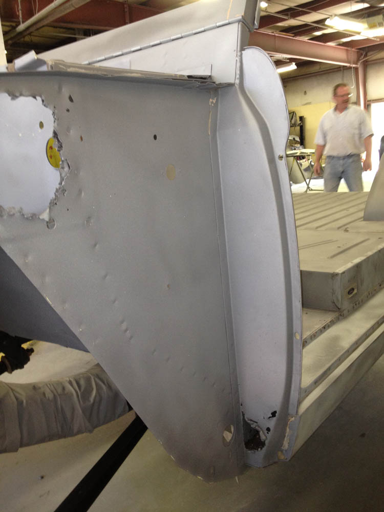

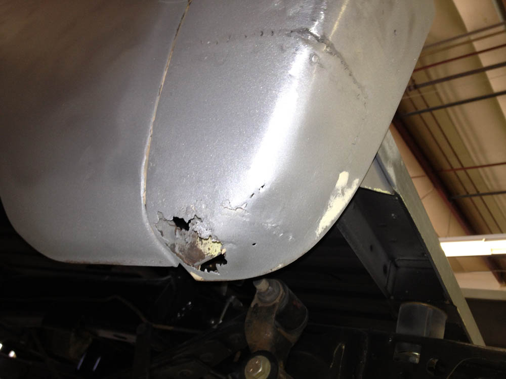

Postby landshark » Mon May 21, 2012 9:39 pm

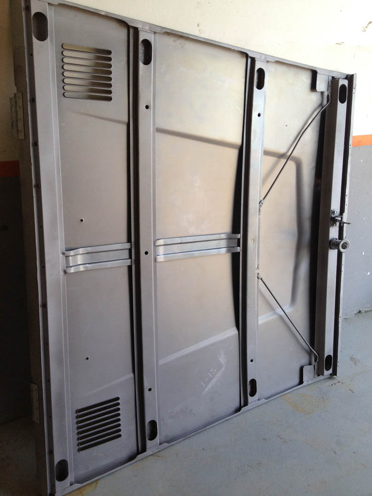

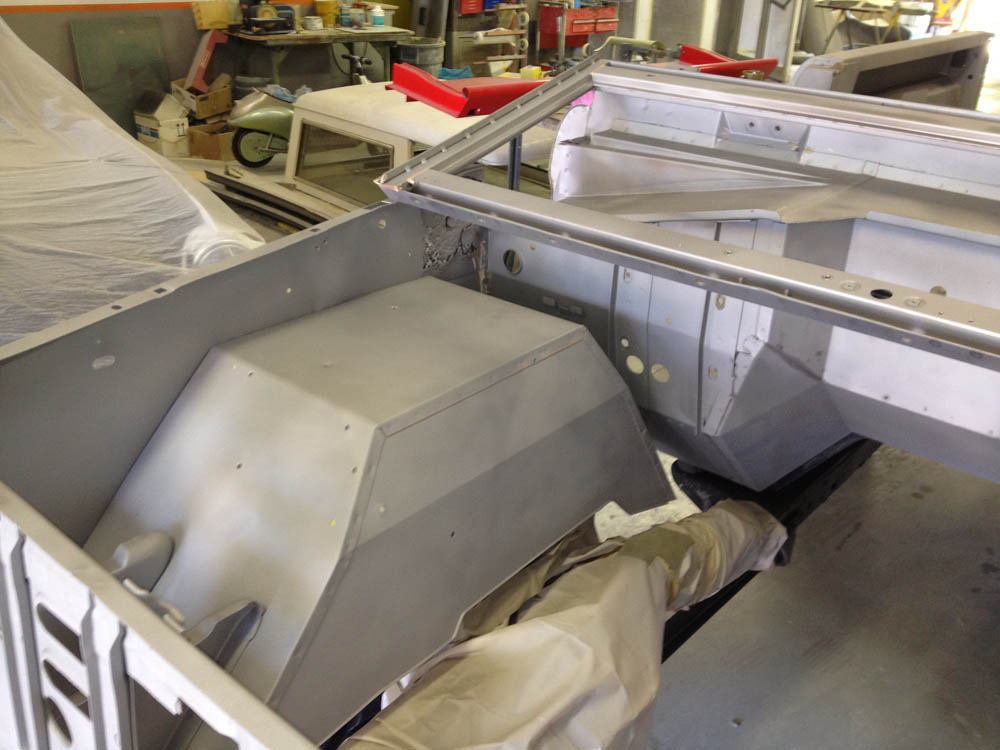

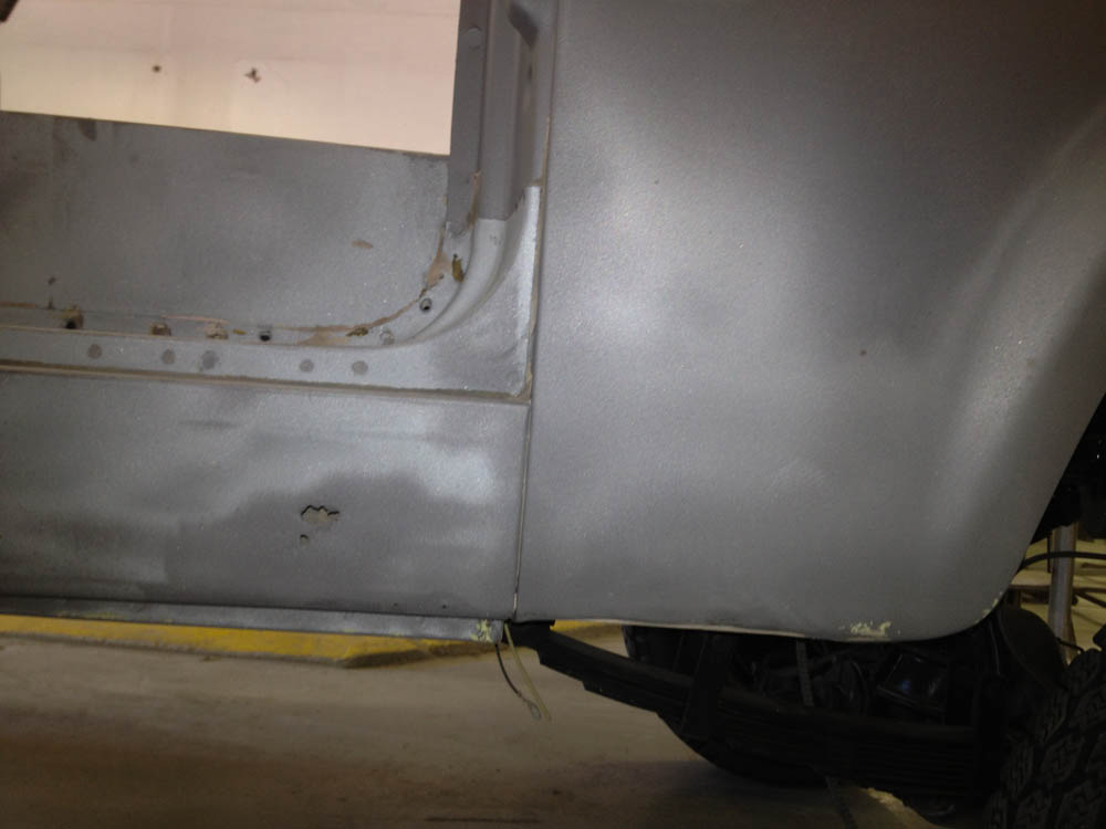

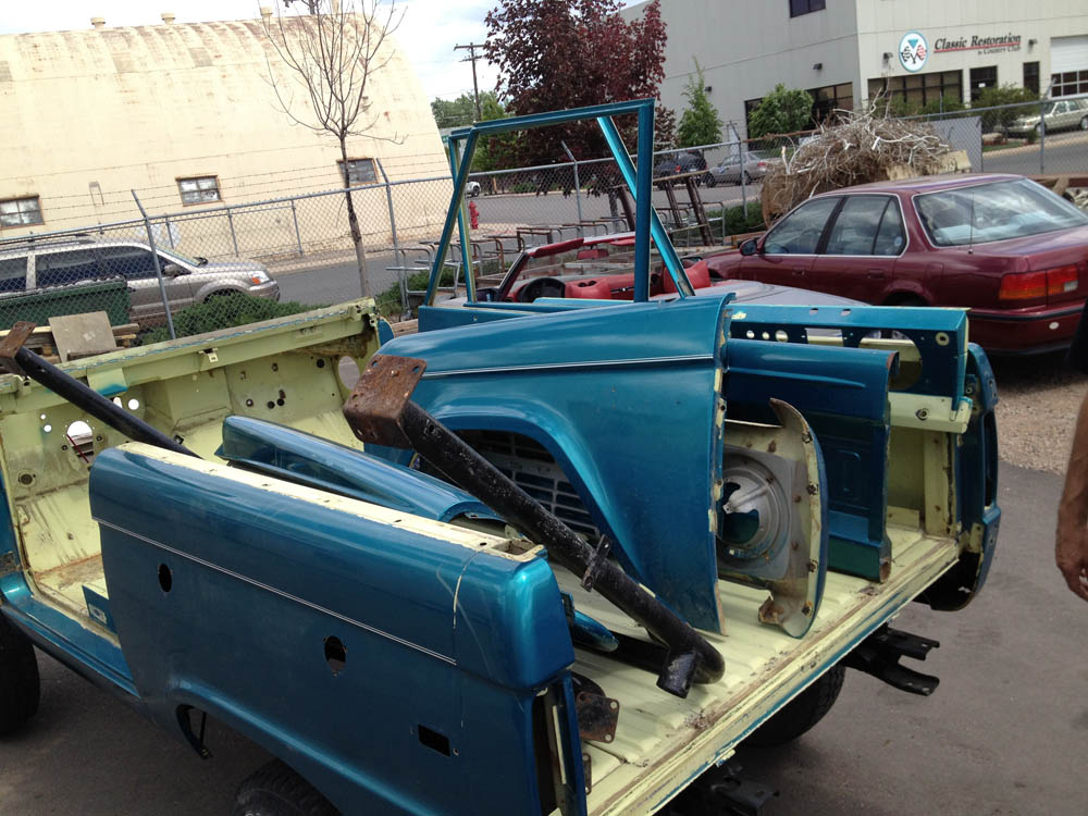

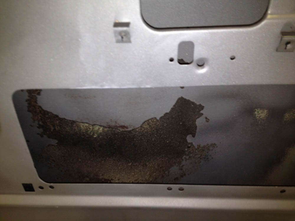

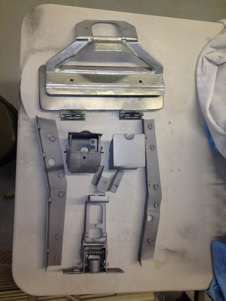

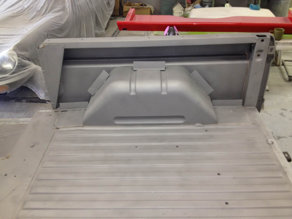

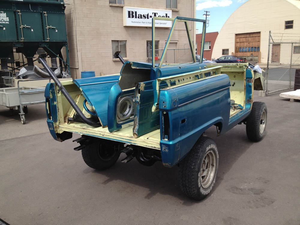

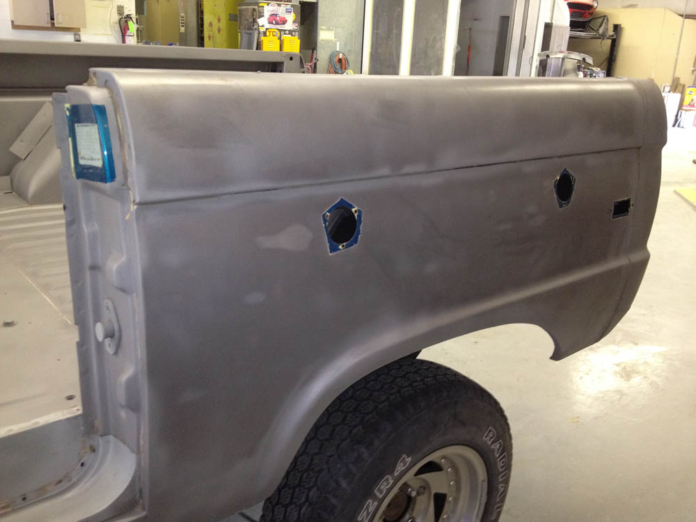

Well visited the blaster on Thursday and they started blasting. Should be done tomorrow. So far no surprises. A little hole in the drivers side rocker.
Will have lots of pics this week but here's a couple before they were done

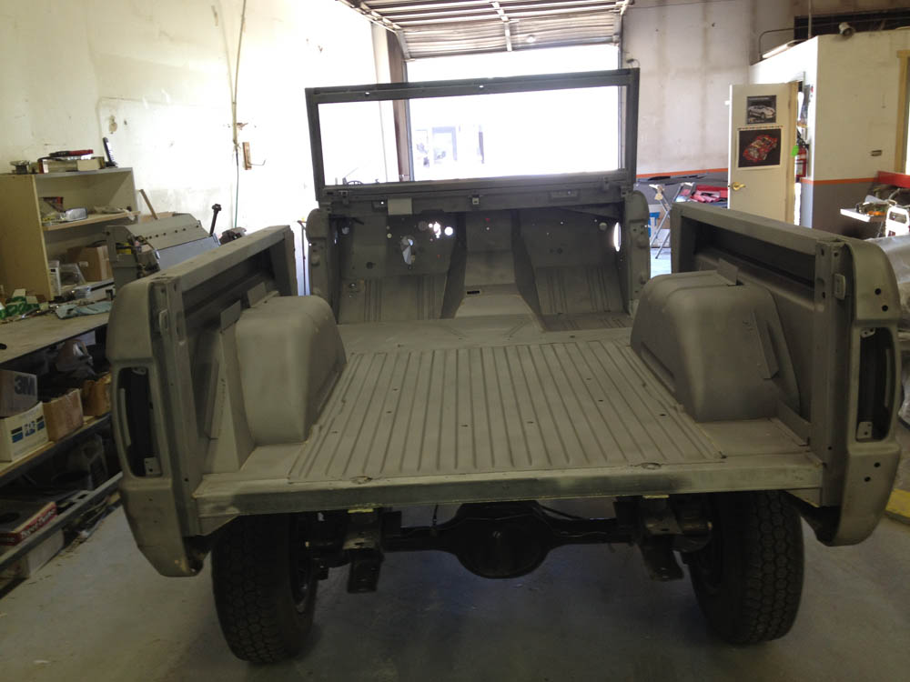

Postby landshark » Tue May 29, 2012 1:53 pm

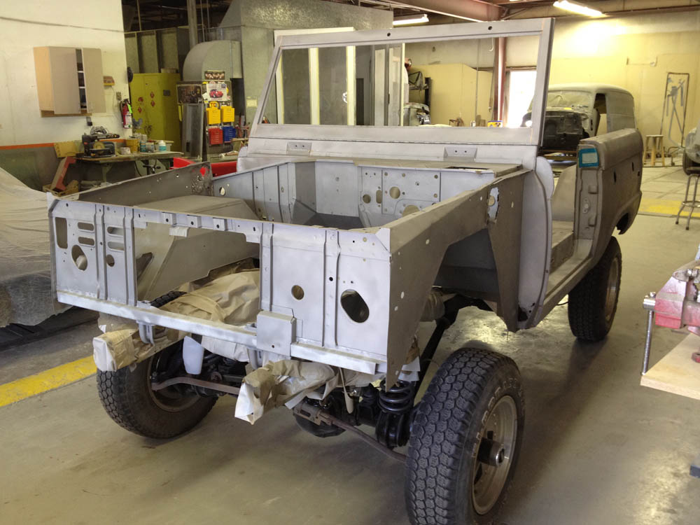

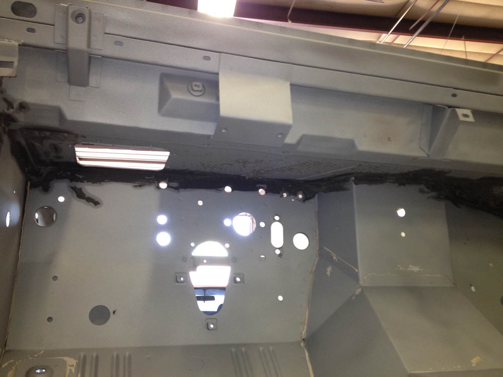

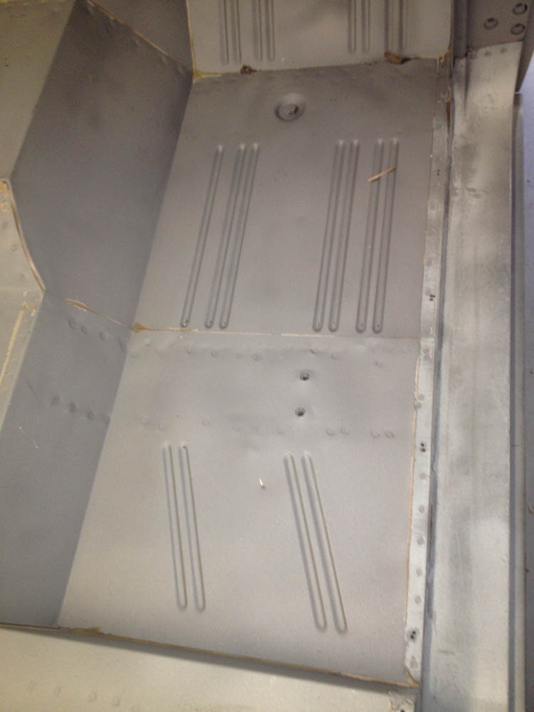

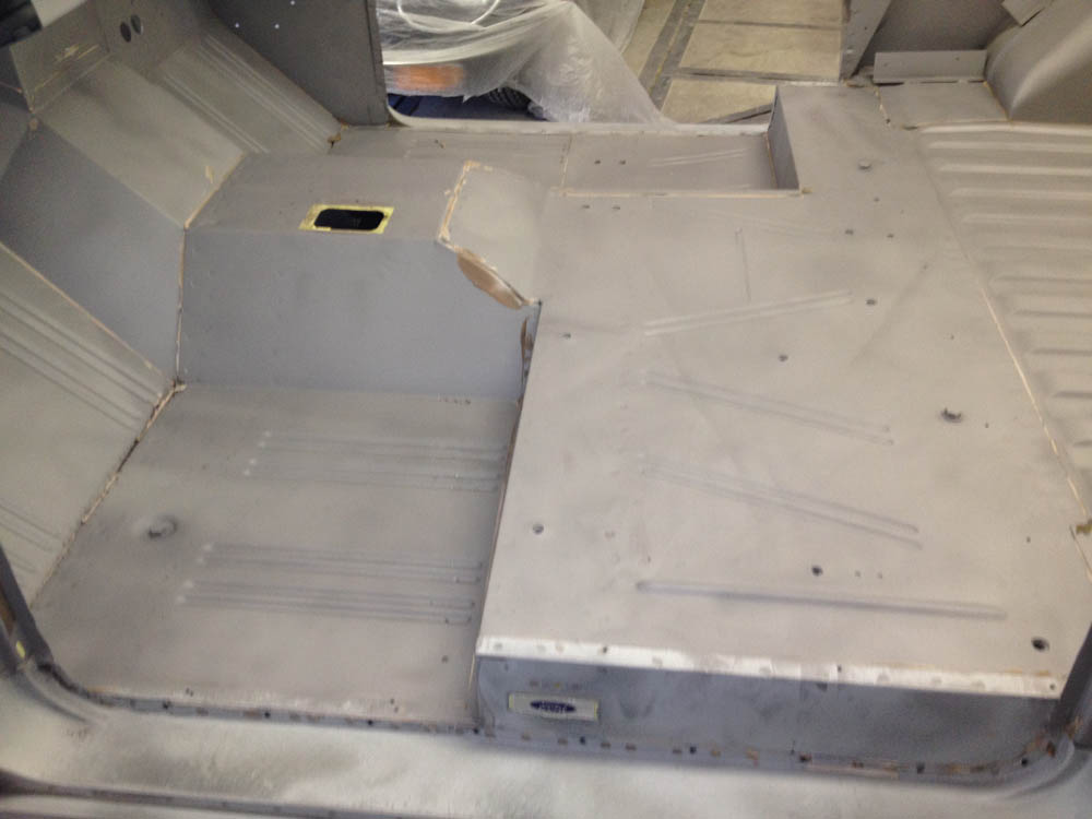

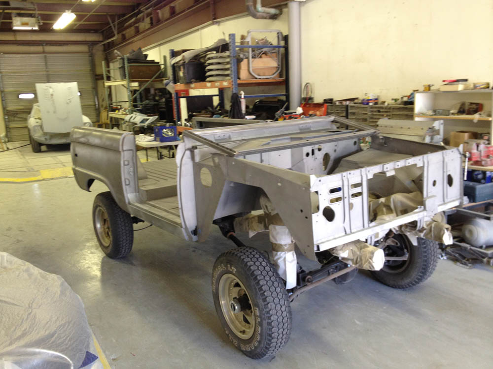

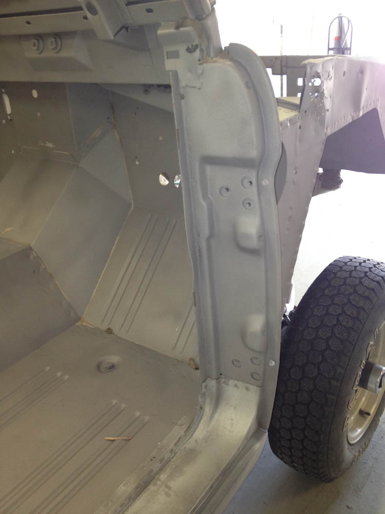

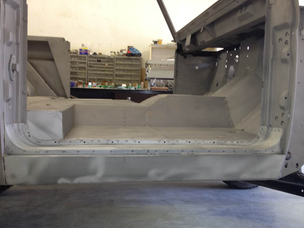

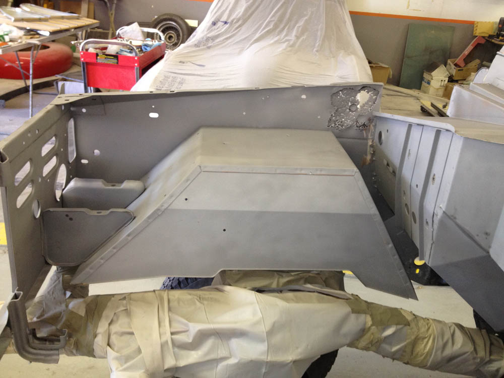

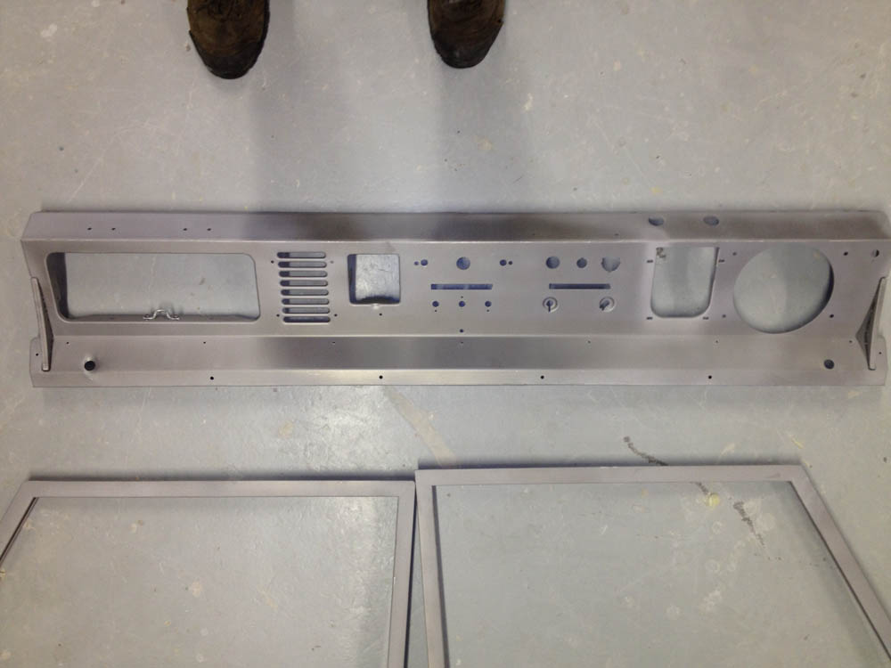

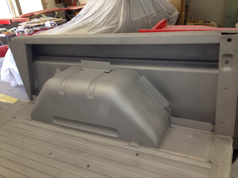

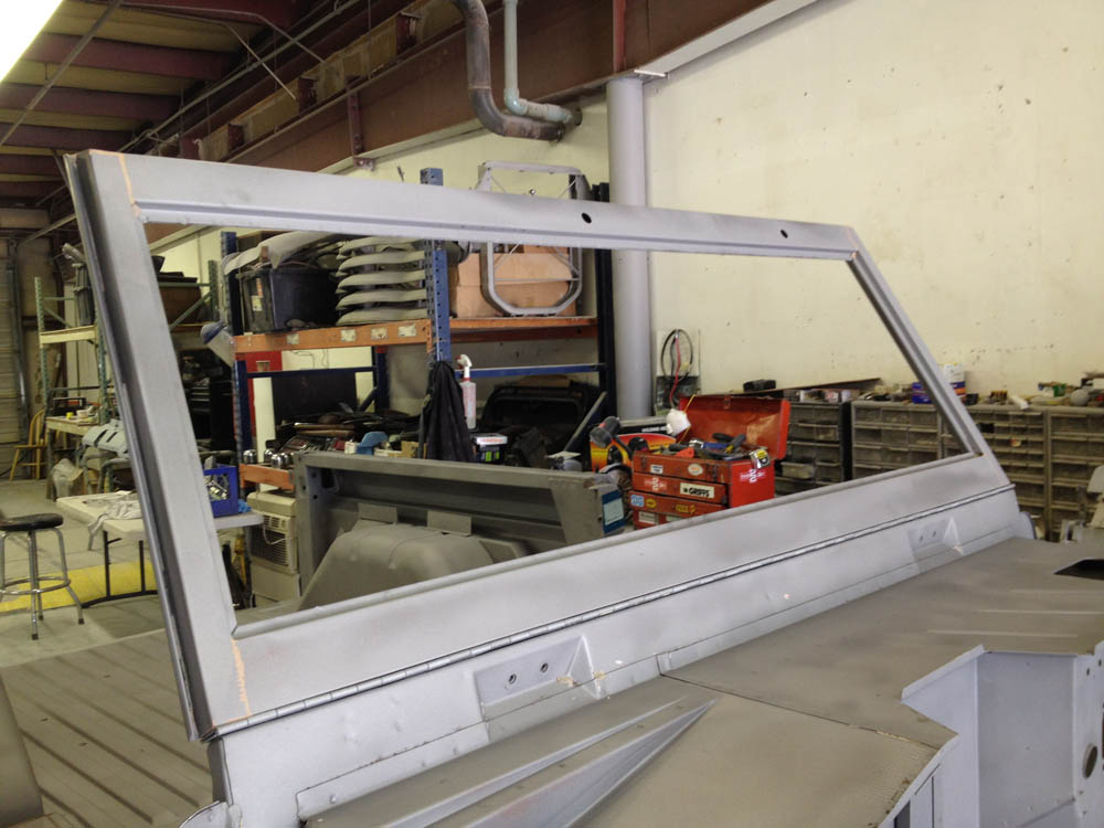

well bronco and all its parts are blasted..
Postby Jesus_man » Tue May 29, 2012 2:02 pm
Got some patchwork to do, but it sure is nice to be able to see it all and know that you repaired everything, then sealed it so in 40 years it'll still be solid!
Postby Entourage » Tue May 29, 2012 3:31 pm
How nice to have the blasting done savining hundreds of hours of sanding and stripping. Can't think of a better present than having the body be that solid and rust-free.
Postby ZOSO » Tue May 29, 2012 4:33 pm
I'm jealous. That thing is clean! I can't wait to get mine to that spot.
Postby Rox Crusher » Tue May 29, 2012 9:25 pm
WOW !
That is a great survivor worthy of what you are doing.
Can't wait to see it progress into a real jewel.
PS..........keep the cost down so the sale price isn't out of my reach.
icon biggin
Postby landshark » Tue May 29, 2012 9:42 pm
thanks guys, ya was nice to have it back from the blaster.. not too many surprises... now onto body patching and building up the engine ;)

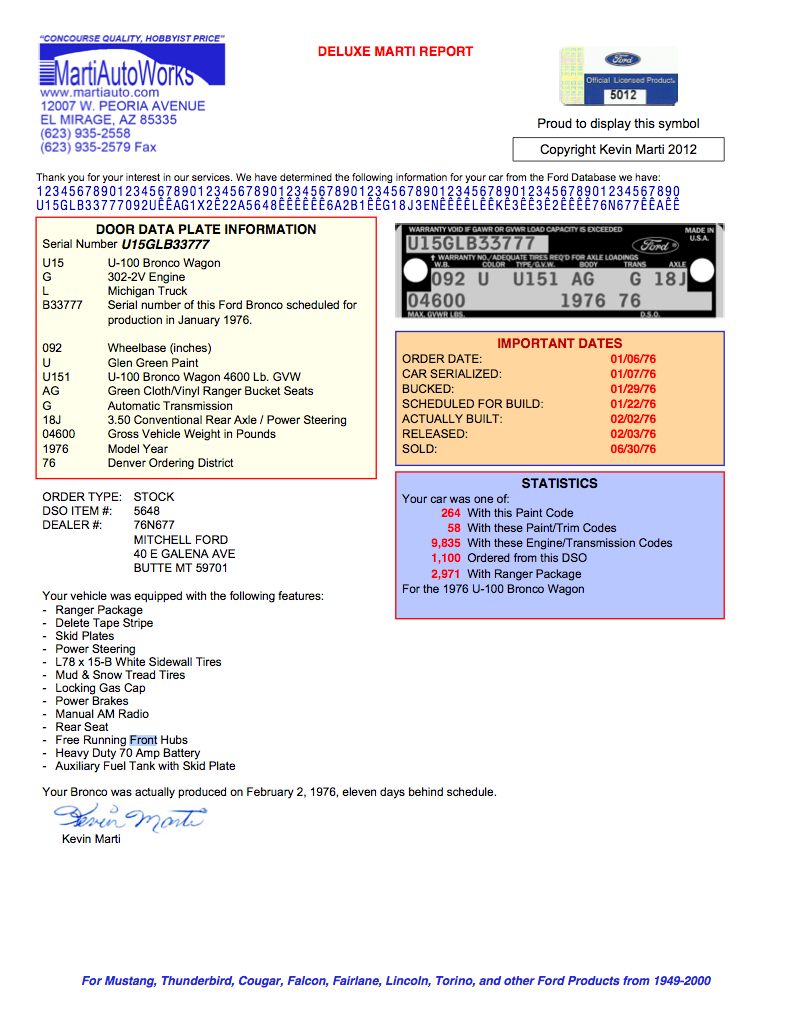

got my marti report...
i figured i had the stripe delete so thats swell. i dont like the stripes anyway ;)
