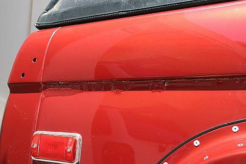

Additionally the horizontal seam between the rear quarters and the bed rails. Not a body guy, so I don't know if I am calling out the part names correctly, but you get the idea. Ahh a pic!

Postby trei75bronco » Wed Nov 05, 2014 5:21 pm
That seem is a common area for rust. The body caulk that was used in the 70s was a terrible product and it allowed a lot of moisture in the inner body panels. All the Broncos expect one which never had the hard top off had that rust. It's a hard one to get rig of too unless you separate the two panels and clean it good. Welcome to the world of Broncos.
