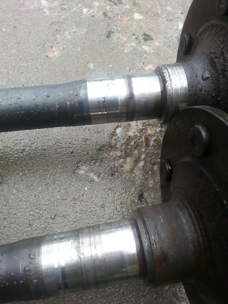

I saw the video you posted. Look that axle over closely before pressing a new bearing on. My brother in laws was a little worse than that and the axle was toast. Bearing ate it up. Couldn't tell until the old bearing was off. Good luck!

Re: rear axle bearings
Postby ZOSO » Sat Apr 18, 2015 10:17 pm
Im gonna go through the whole thing. I do have a fear the axle is toast.

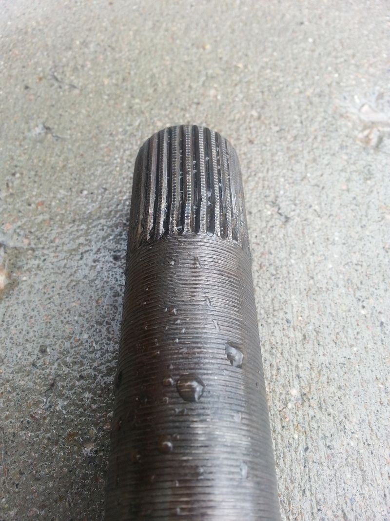

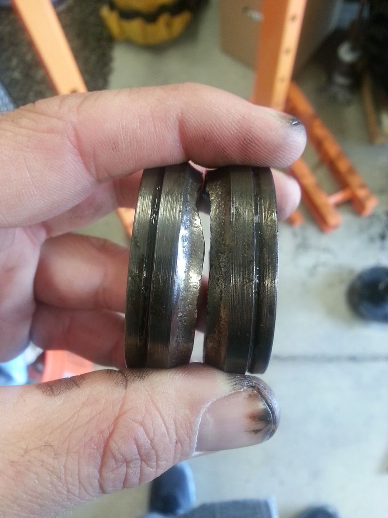

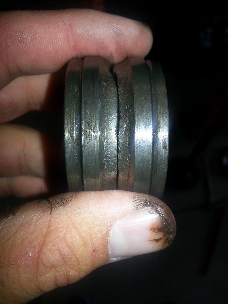

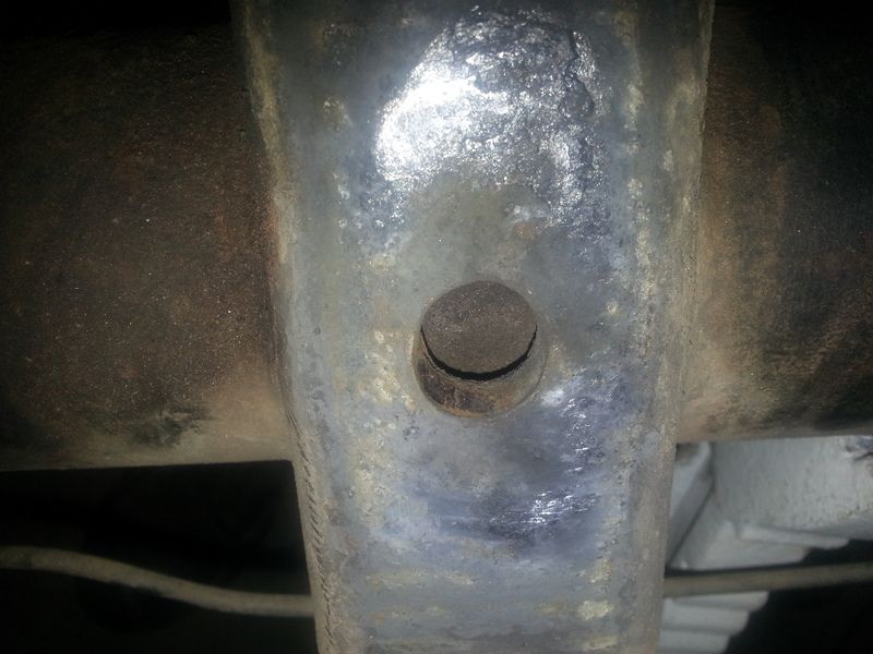

Ok got the axle apart this weekend. This is what I found. The drivers side bearing fell apart when I tried to press it off. The bearing surface on the shaft looks good. Splines are a little twisted. Im gonna slap new bearings on it and go for now. No point in spending money on new shafts when I want to go 31 spline soon. The centering hole in the spring perch is ovaled out too. So i'll be adding WH big perches.

From what the axle experts say spline twist is actually normal and expected, needs to go to about a spline off before replacement.
