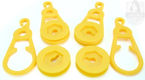

The rule of thumb if you are thru-bolting something, is to "pinch" the frame with the bolt instead of allowing the dia of the bolt to hold things in place.
Think about a tarp. If you pull string a rope thru a hole you made, it'd tear thru pretty easy. But if you use one of those clamps:
it'll hold much better as it has more material.
I actually cut mine off to be able to pull the bumper in as close to the body as possible to improve approach angle, which is important when off-roading. You don't want a shovel hanging off the front.

Jesus_man wrote:The rule of thumb if you are thru-bolting something, is to "pinch" the frame with the bolt instead of allowing the dia of the bolt to hold things in place.
As far as placing the shims on the outside of the square tubing to give the horizontal mount bolt more strength?

Yes. And collar on the inside is a good idea. This sandwiches the frame against the 4x2 you are placing on the inside without warping it.
